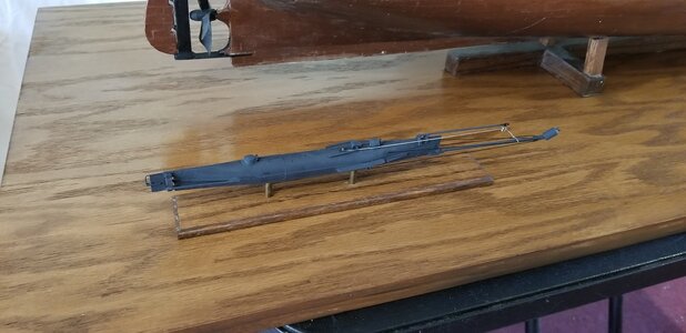

Displayed on line is another model of the Housatonic. I could never find out where it was displayed. That model had included a model of the Hunley that inspired me to also include a model of the Hunley. It’s a nice contrast their size.
I constructed the Hunley using a design from a resin model. I scanned, 3d printed, resized the parts from the kit. I assembled and added my own details to complete a 1:64 model. Ah, technology.
