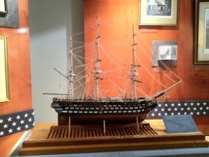

Resources:
Photograph by M.C. Farrington
The Hampton Roads Naval Museum is an official museum of the United States Navy and reports to the Naval History and Heritage Command in Washington, D.C.

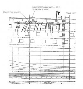

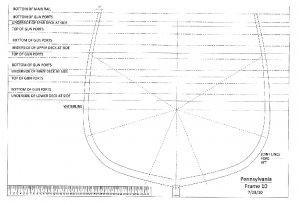

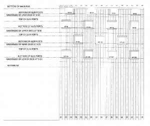

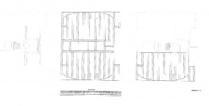

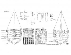

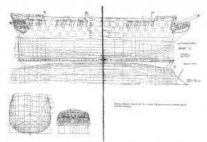

The Drawings:
The original drawing is by Howard Chapelle, model plans and sections by Jeff Staudt, the sheer and frames are by myself.
Pen_1 (2).jpgPen_2 (2).jpgPen_3 (2).jpgPen_4 (2).jpgPen_5 (2).jpgPen_6 (2).jpg

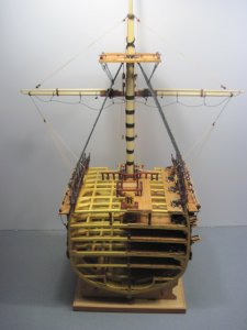

The Model:
The model is based on drawings from the book The History of the American Sailing Navy by Howard Chapelle and drawings by Jeff Staudt. It will be 8” long 12” wide and 36” high showing 30-gunports and the main mast up to and including the fighting platform. I revised my gantry to accommodate the new model made it wider and taller and added a level.

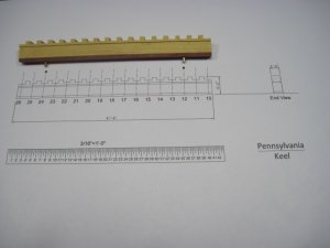

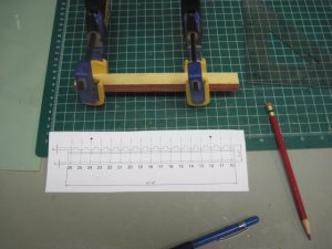

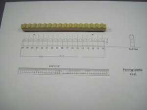

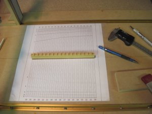

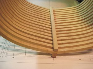

The Keel:
The keel is made from yellow hart it machines well and takes a nice finish. The keel has two 3/32” holes drilled in the bottom with pins made from 3/32” brass tubing and project into the baseboard ½” the fit is very tight and holds the keel firmly in place. This is a few photos of the keel.

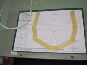

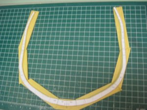

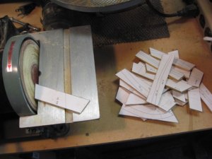

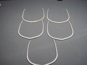

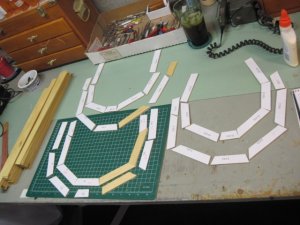

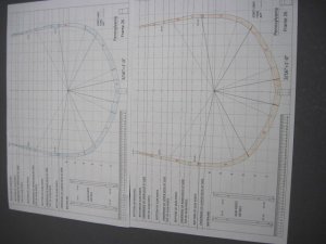

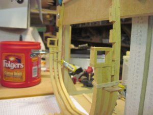

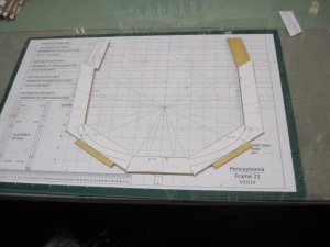

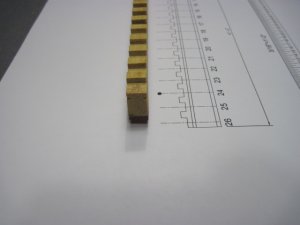

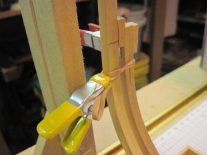

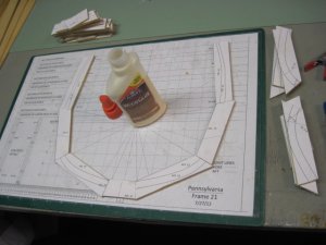

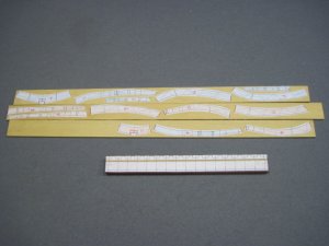

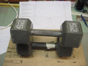

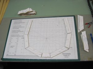

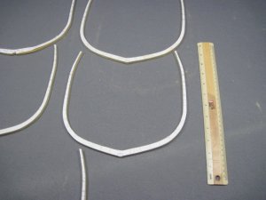

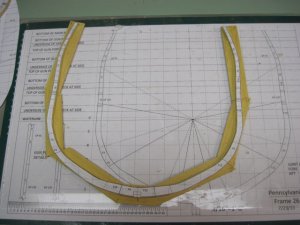

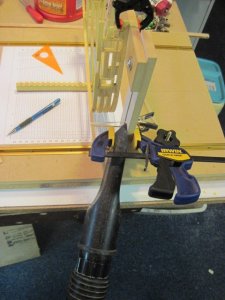

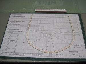

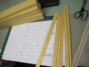

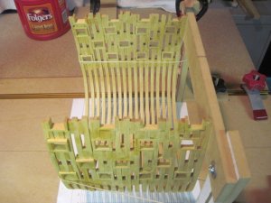

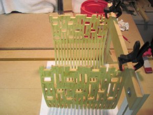

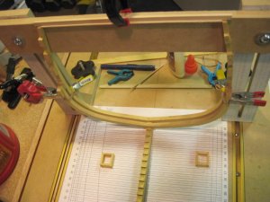

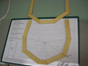

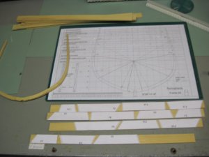

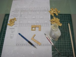

Frames:

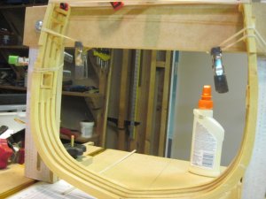

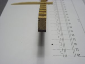

The 17 frames are all double frames consisting of eleven sections made from yellow hart using Harold Hahn’s method to construct the frames as shown in the following photos.
Please note I use a special forty-pound frame press to ensure a good bond between each side of the frame.
IMG_3153.jpgIMG_3154.jpgIMG_3155.jpgIMG_3156.jpgIMG_3157.jpgIMG_3158.jpgIMG_3159.jpgIMG_3160.jpgIMG_3161.jpgIMG_3162.jpg

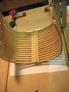

Frames continuation:
A few more photos of the frame construction.

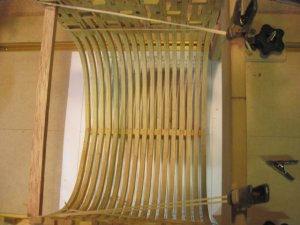

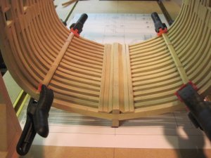

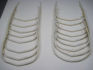

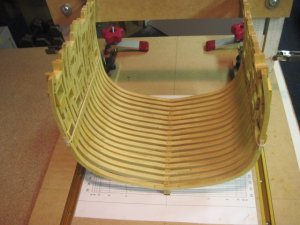

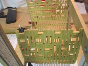

Finished Frames:
The assembled frames ready to be installed on the keel.

443
Hi Mike,
I use AutoCAD to do the drafting and have a 11x17printer, it works great for the large frames. I must splice sheets together on long plans but it is cheaper and faster than having them printed at a print shop. This is a large model even at the 1:64 scale.

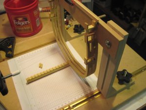

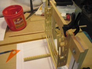

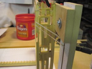

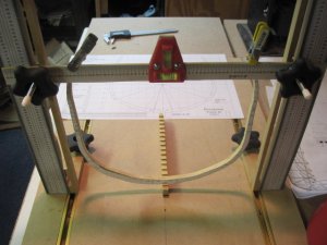

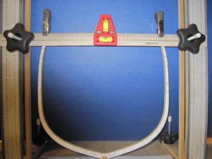

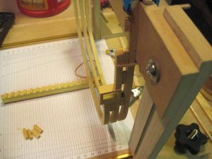

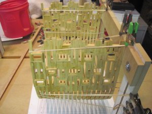

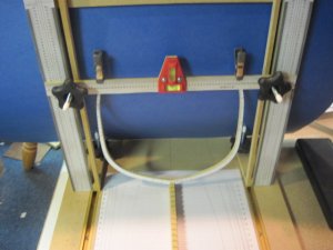

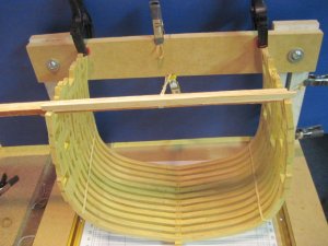

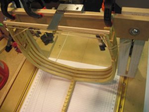

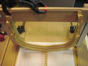

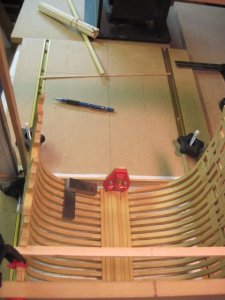

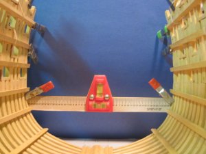

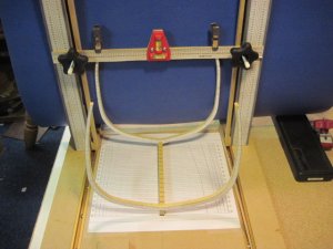

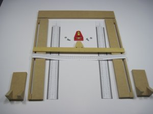

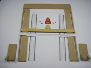

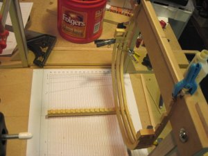

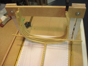

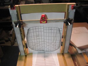

Gantry Set-up:
The following photos show the gantry the frames being leveled in the keel prior to gluing.

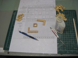

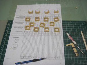

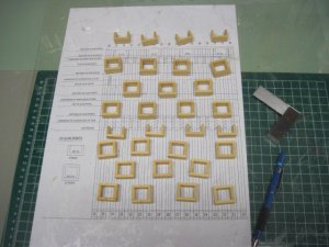

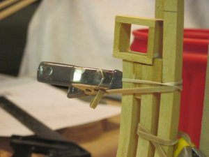

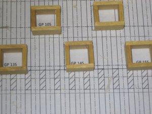

Gunports:
I am using box liners in the gun ports to maintain a consistent size and appearance. This is a few photos of the assembly.

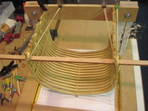

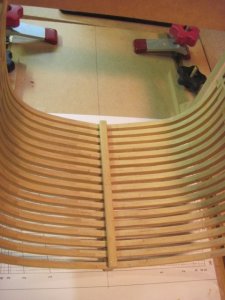

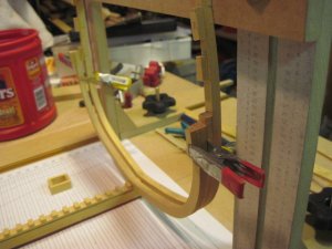

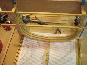

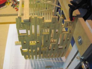

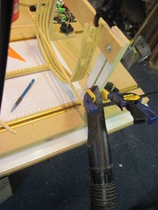

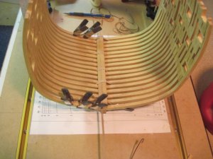

Frames Installation:

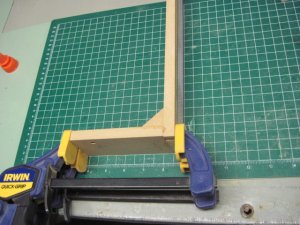

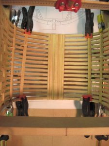

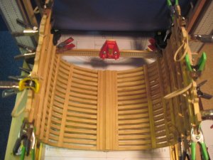

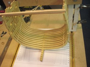

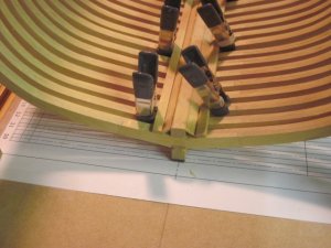

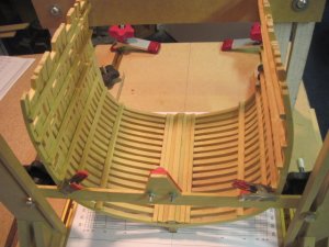

I started with frame 10 it is one piece at the end closest to the bow leveled and glued it to the keel. Frame 11 is in three pieces I marked the elevations on the first frame 10 installed and glued four spacers to it then leveled and glued the bottom of the third frame in place. Using spacers, the first two gunport frames are glued in place. I used spreader bars on the top of the frames to keep them on center and beams between the port and starboard gunports to keep them level. This method Is used to install the remaining frames. This set of photos shows the clamping and gluing procedure.
IMG_3185.jpgIMG_3186.jpgIMG_3187.jpgIMG_3188.jpgIMG_3189.jpgIMG_3190.jpgIMG_3191.jpgIMG_3192.jpgIMG_3193.jpgIMG_3194.jpgIMG_3195.jpgIMG_3196.jpgIMG_3197.jpgIMG_3198.jpgIMG_3199.jpgIMG_3200.jpgIMG_3201.jpg

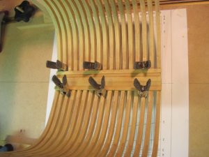

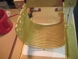

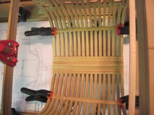

Frames Installation (continued):
This is a few more progress photos of the framing. All the frames are now in place.

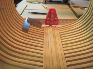

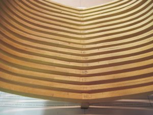

Keelson and Limber Strakes:
The Keelson is installed with two 20 gauge brass pins at each frame. The following photos show the installation.

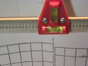

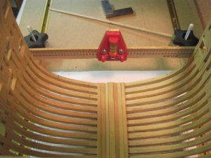

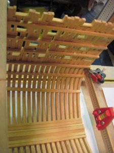

Deck Clamps:
The deck clamps for the Five decks were installed next. The scales and level on the jig made it easy to get the clamps in the correct position. The following photos show the installation.
