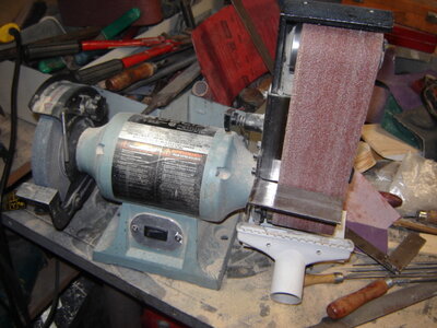

This is my go-to tool for shaping wood. Lately it's been burning the wood. Could this be anything but a dull belt? It just seems a little soon to be changing the belt.
Is hardwood a lot tougher on belts? I've had this sander for years and never had this problem before but I wasn't using much hardwood then.

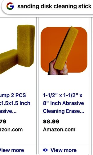

Edit Thanks Steve For some reason I had you set to ignore. Have no idea why. I'm not ignoring you any more:) Anyway, I have been meaning to buy one of those sticks. I bought a cleaner for my orbital sander and it didn't seem to do much
Edit2 I ran the heel of an old gum boot against it and it helped quite a bit. Thanks

If you can’t adjust the speed on your belt sander, just use a lighter pressure against the belt. Also get a sanding belt leaning erasure. Sawdust clogs the grit and decreases the ability to sand the wood. The erasers can be bought on Amazon or at Home Depot. Very inexpensive but worth having. 1628960936125.jpeg

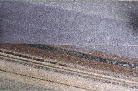

here is an example of burns
top is a new 80 grit at the upper right is after some use and that can be cleaned and you can keep on using it
bottom example lower left is after a lot of use next up from the left the grit is getting dull and begins to clog beyond a cleaning and burn streaks begin to show up upper section once you get a burn like there the belt is done and should be replaced. You can clean the burn streaks but it will still keep on burning the wood
