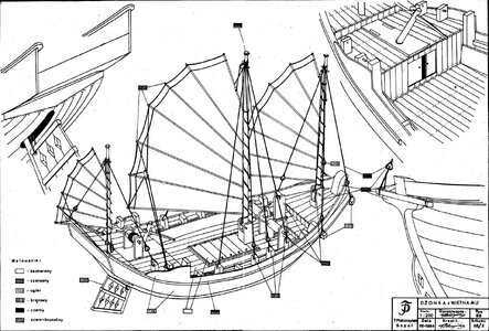

There are several plans for kit models of well-known brands on the market, but a model entitled “Dzonka Vietnamu” – Skala 1:200 was chosen, obtained from the article “Dzonka Wietnamska – Tadeus Piskorzyrisk” Modelarz Magazine, October 1984.
3. Model construction

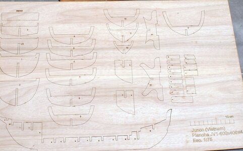

From the plans shown and the hull lines, the sections for the frames, the shape of the deck and the dimensions of the mast were obtained. It was drawn in AutoCAD and the frames and main parts were laser cut from 4 mm and 1.5 mm plywood sheets. The dimensions of minor elements were taken to scale from the plans and photographs of similar ships.

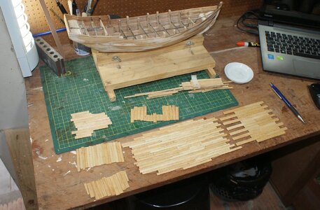

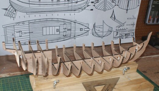

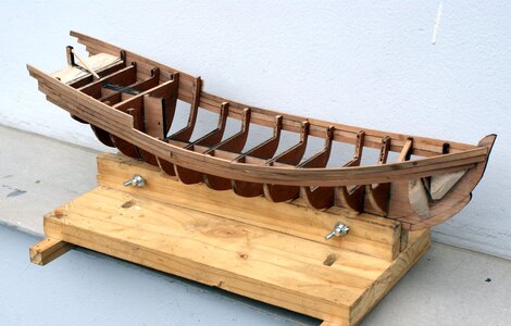

The pictures show the planks and the first part of the frame assembly. Balsa wood fillers were placed on the bow and stern to enable the hull to be given the proper shape. 2x5 mm strakes were placed and then a mixture of putty, sawdust and white glue was prepared to fill the joints and deficiencies of the first skin. After sanding, the topsides were painted with ochre-coloured paint and the bottom was covered with 0.5x5 mm zapelli strips which were darkened with very diluted opaque varnish and sanded.

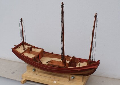

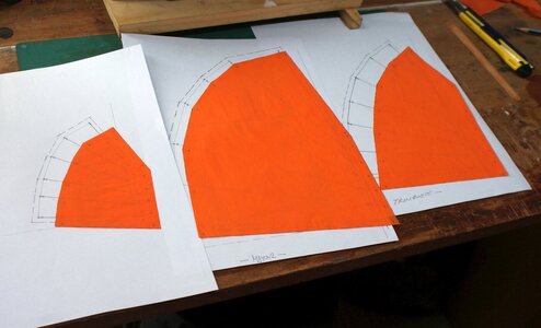

The shape of the deck had to be rectified and the planking was prepared on it with 0.5x9mm strips, placed in a three-by-three arrangement, the nailing was simulated and aged with Judea bitumen. Then the deck elements such as the entrance to the hold, winches, centreboard, bitts, masts, etc. were placed. The dimensions of the sails were taken, which were made with tissue paper, applying orange acrylic paint on both sides, to give it firmness. The boom and intermediate rods or battens were glued on them and before mounting them, all the tacks and blocks were fixed to the sail.
The sails were mounted with all their elements on the masts, as well as all the running rigging. The mizzen was started with, the main mast then the foremast. The shrouds were placed with thicker thread.
