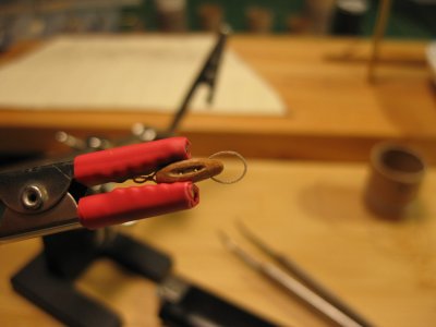

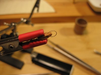

A little update, little in parts not job. That was big.
all the blocks and the blocks attached to the yard.
View attachment 539039View attachment 539040View attachment 539041View attachment 539042View attachment 539043View attachment 539044

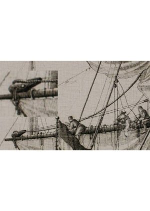

These blocks on the yard are big. I found this drawing online source vaartips.nl Tekening van Frederik J.Weijs
wow, what kind of huge violin block is that? It must be really heavy in reality?
Just goes to show how hard it was as a sailor......

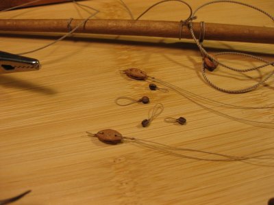

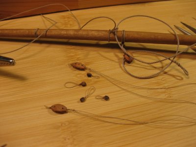

Again not much time (I hear to much often "Stephan? ....")
But between all the household keeping and other things in, a small update for now.
pictures say everything
And I need rope, my stock is slinking.
The keen observer will have noticed that the thin rope is LH rope and not RH. This is because I use Serafil rope for 0.18 and 0.24 mm, which is 120/2 yarn. When I make 2x1 or 3x1 rope from this, I can only twist it LH. The yarn consists of two 120 thickness yarns that are RH twisted. If I use more yarns per skein, this is possible and will produce a nice result. The fact that the thin one has the wrong twist is hardly noticeable to the naked eye, only in the macro photo. I have Skala available and I could make it with that, as well as RH.

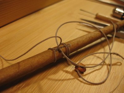

View attachment 539667View attachment 539668View attachment 539669View attachment 539670View attachment 539671View attachment 539672View attachment 539673

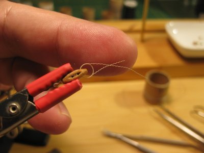

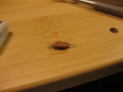

My first ship was 1:100 scale, and yes, you can omit many details, such as deck trenails, because they should not be evident on such a small scale. However, there are some details that should be evident, but the tiny scale prevents you from adding the detail because it is too difficult. Take for example, gun tackles. Even at 1:150, you should be able to see them, but it is practically impossible to get line and blocks small enough to keep gun tackles in scale. Also, no one has make parts that simulate gun tackles on that small scale as a product. Perhaps the tackles could be simulated with the smallest of 3-D resin printed parts, painted and glued to the gunwales and carriages with enough detail to appear as gun tackles to the viewer. Actual blocks don't get much smaller than 1.5mm, and the line is basically thread at a small scale, and even then, the blocks are a bit oversized at 1:100 scale. As someone who attempts to place as much detail in a small model as possible, given my intermediate skill level, it is a source of frustration when a detail you should be able to see is not practical to create because of scale limitations on materials, tools, or access using tools. As such, compromises must be made. This is why some modelers choose up to 1:48 scale where they add tons of details which are a feast for the eyes.
