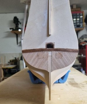

Hello Udo. This is a great build so far. Just a suggestion. On your closed gunports, the planking does not follow the pattern of the rest of the stern. I would suggest that they be the same.
Absolutely right, gun ports are fixed!

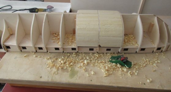

In the meantime, I have started filling the frames with abachi wood to provide a better base for the single planking.
