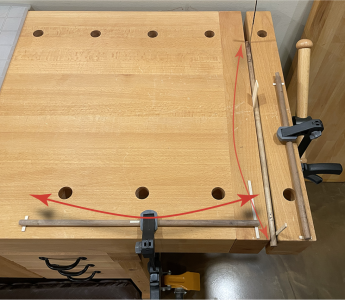

I've just reached the masting phase of my build and sadly discovered that the lower mast dowels for the Foremast, Main Mast and Mizzen are warped significantly. They all appeared fine as packaged in the kit, but displayed this problem after removing the elastic bands that held them together. I'm looking for suggestions for straightening these. I've used the following technique on sample pieces of maple (which these masts are made from).
A. Soak the dowels in water for 24 hrs.
B. Remove the dowels from water and fasten to straight/flat surface with "correcting shims"
C. Blow dry with heat gun set to 300ºF till dry (about 2 minutes)
D. Apply a penetrating oil (non-tinted) and reset the clamps and shims
E. Let sit overnight then remove.
This corrected the warp and the penetrating oil should stabilize the dowel fibers - but I'm uncertain if the warp will return after these dowel are installed on the ship.
Looking for suggestions please :)

My instinct would tell me that warped dowels can’t be permanently straightened, but I have no research to back that up. I think most of the old hands on this site would recommend pitching the kit dowels and making new dowels from a piece of nice straight-grained lumber.

If Model Expo does not replace this , I think they will thought, I agree buy a new one,just in case it does warp again. 6 months after you finish. But that's just me lol.

I think your dowels will return to their warped condition over time. Make your own from square stock.

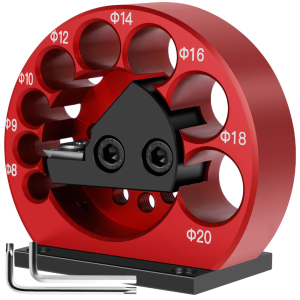

I agree with the above post from @Steef66 Buy the square stock and turn them into any diameter you want/need using this or similar tools. It is 15.99 dollars on Amazon

I agree with the above post from @Steef66 Buy the square stock and turn them into any diameter you want/need using this or similar tools. It is 15.99 dollars on Amazon.
Cool tool! But it negates one of the advantages of square stock. When starting square, you cut the taper first while things are rectangular, which is easier, then round things off (or keep some sections square or rectangle depending on requirements). Fair winds!
