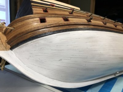

Ahoy there mateys!
I'm still gathering information on the colouring of the Was ship.
I have the basic wood colour sprayed onto the hull and decks as well as the red. I've also drilled out ALL of the holes in the deck and forebeak gratings.
I'm wondering if the Was was painted WHITE below the waterline? Does anyone here know?
Cheers

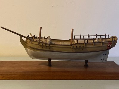

Seventeenth century ships are often depicted as whitish below the waterline. This was not paint but a coating of tallow and other stuff. The color might vary depending on the other stuff. With tar, darker. With lime, lighter. With sulfur, yellower. In any case, I would suggest that a model shouldn't be too white but look kinda dirty. Pictured is my idea of the schooner Sultana of 1767. Fair winds!
