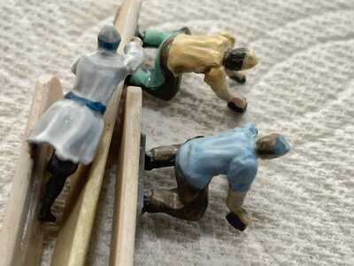

Basic washes: 50% acrylic Media: 50% water: 1/20 flow aid. I use Liquitex pro for my media. I'm still just learning, so below are not the greatest. However, you can see the shadow/contrast that a wash creates when simply applied all over after painting. Works well with any color (I mixed mine from a few primary colors). Note: The figures are less than an inch each.
@Quint: just wow!!! very nice. ;-)
