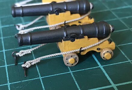

Waxing or not waxing the threads? Waxing ofcourse offers a better standing of the rope and an easier binding. But wax brings dust on the rope, makes the texture of good quality model rope to look dull and flat.... and lastly there is always the danger of acidity on the long term.
So am very sceptical if is better not to use wax. And if use wax am not sure which kind of wax is better. Normal candle wax oris it better to use the nice soft furniture bee wax?
And how about sagging depending of the humidity? There is no solution to this I know of. Is there one?
