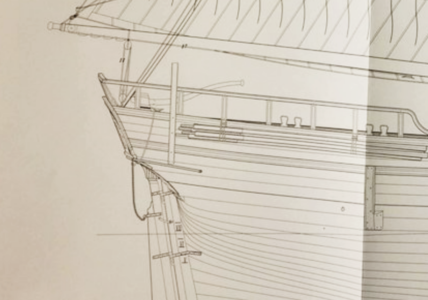

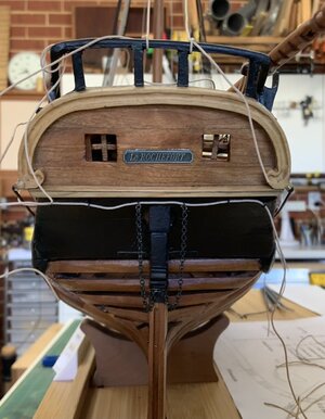

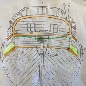

Can someone help identify what this rope is for on the stern of my French 18th Century Port Yacht? Highlighted green on the plan. I’m still at the rigging phase. 2D0A360E-E1A4-47BE-B081-6D1C449696B4.jpeg53596785-39B0-4D4F-AC32-C7D4DDFE101F.jpeg
Can someone help identify what this rope is for on the stern of my French 18th Century Port Yacht? Highlighted green on the plan. I’m still at the rigging phase. View attachment 340002View attachment 340003

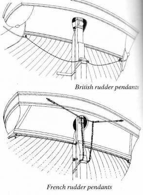

They are called Rudder pendants and are there in case they lose the inboard tiller and they can use it for emergency steering, also they can be used to reposition the rudder if it comes adrift,
best regards john,
and on the sideview of the planset you can see this rope going up to the deck
