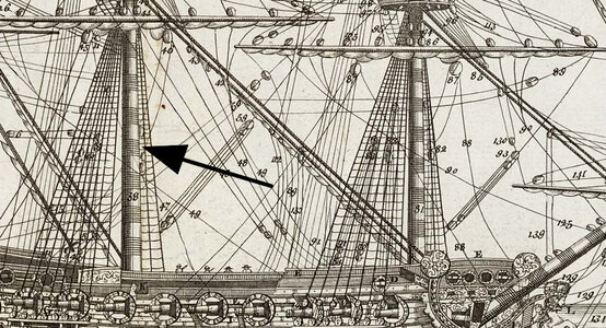

Hello. What are these ropes called that are situated on some masts? Some masts do not have them, and what are their purpose?
You can find something similar on the Victory's mast, but there it is made of iron; as far as I know it serves to stabilise the lower mast, which in earlier years was made of cordage. I think it is rather unlikely that contact with the sails would prevent a chafing effect, but perhaps not entirely out of the question?
These are called woldings. As masts were fashioned from several lenth of timbers joined together (especially the lower masts), the woldings were fitted to strenghen the assembly. The ropes were complemented by wood strips above and below to stop and keep the rope in place. At some point, the ropes were a were replaced by metal bands.

Woldings provide compression force to the mast, which reduces the tendency for the wood of the mast to split along the grain after many cycles of flexing and bending under the force of the wind on the sails. Example: Grab a handful of straws, then try to bend the bundle. Some of the straws want to slide against each other on the inside of the bend you are making, and the cross section of the bundle wants to go from a circle to a flatter oval. Also the individual straws compress into oval, and then flat cross sections as the bundle is bent to extreme. This sliding motion and the change in cross section of the bundle demonstrates the shear force along the grain of wood within a mast when it is bent.
The mast is stiffened against these internal forces by the bands of compression offered by the woldings. and the mast will retain its cross section shape because of this support. If it were not so, splits would begin to occur along the grain within the mast, and the mast weaken faster over time. Masts are routinely replaced in ships every couple of decades or so, the frequency of which depends on the funding available and availability of the proper timber. Mast replacement is one of the many things required for the expensive maintenance of ships. Extending the life of masts is essential in reducing the enormous costs of maintaining a ship.

The masts were constructed composite by putting together several elements, which were fixed together by collars and wouldings
Tke a look at this topic, were the construction of a mast was explained
