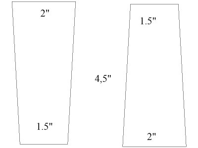

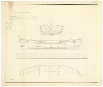

Thank you kindly Smitty. That is what I was hoping it would be. Case in point in the plan below. The gunwale in the top view flares out at the bow.
Sorry for complicating things but the gunwale could taper like some of your posted sections with 1-1/2” the top thickness and 2” the bottom.

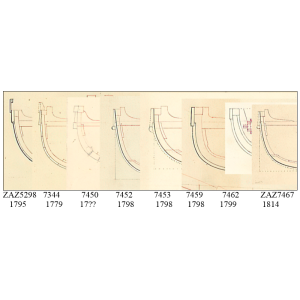

Corporal Smith's analysis makes sense. I thought the same without the help of ChatGPT, which I wouldn't consider an absolute authority, but, in this case, it makes sense. It also makes sense that a bit of "beef" would be added amidships since that's where the boat is most likely to bang up against anything, fendered or not. Also, from a visual perspective, a fair widening matching the widening of the hull is undoubtedly more visually pleasing. The same width bent around the lenth of the hull's curve would look... well... "carpenterish." :D
a) Two different stations — e.g., 2 inches at the midship sections, 1½ inches toward the ends (common in small craft to save weight and because less strength is needed at the extremities).
Exactly right! Many long pieces of wood on a ship are tapered, including spars. This is because the maximum bending stress is at or near the middle if it's acting as a simply supported beam. If such a member is the same cross section over its entire length it would be either too weak near the middle or too strong (and too heavy) near the ends. A mast acts as a cantilever beam with maximum stress at the partners. Regarding the concept of tapering being visually pleasing, I suggest that this is an example of physics in the natural world affecting aesthetics. Things in nature like tree trunks, tree limbs, and human limbs evolved as tapered to optimize for physics; therefore humans are inclined to see that as normal and pleasing to the eye. Fair winds!

Is the below what you are suggesting?
Thanks
Yes. Ditto to what Andy said. It seems to be the most logical explanation. I'll also add at this juncture that if the part is to be bent into place, the tapering ends are going to make that a much easier task.
I share your enjoyment to the discussion. Learning something new is always fun and it keeps the mind supple as well! ;)
