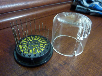

I bought a set of Gyros Bits from Amazon. At least they came with the nice dome drill bit stand.

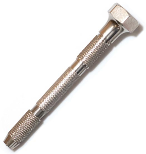

Much to my surprise, I have found that small wire sized drill bits work quite well drilling hard brass in my full sized drill press. I Chuck them in a pin vise and run the drill press at a low speed. I thought that they would break by buckling but they seem to cut fast enough that such is not the case. I use them “dry” without cutting oil.
