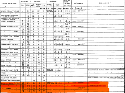

I am trying to figure out what size to use for the carronade tackle blocks on my model ship. I was wondering if anyone would know the size of the single and double blocks on the actual carronades of the actual ship?

I think I may have my answer. When I look at the following table it says the length of the block shell is 8 inches. That's good enough for me.

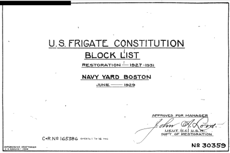

The figures below show the table as well as the title page of that document.
So, since my scale is 1/76 then the block size is 2.7 mm.
