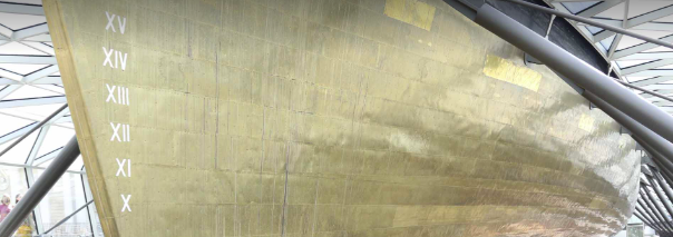

You can see in the image that the brass on the C-S at Greenwich (as restored) is quite a pale greeny/yellow but I am not sure if they used actual Muntz or just a standard brass alloy when they re-sheathed it?

The problem with trying to base your paint scheme on the real thing is that the colour changes with your position, the light, the time of day and so on. I spent hours looking at the hull (the cafe is under the hull) and the colour is everything from coppery to brassy. Personally, I used a Vallejo bright bronze all over, then washes of gold, brass and copper until I liked the end result. Does it look like the real thing? Not really, but I like what I ended up with anyway.
To illustrate the issue, here are a few photos all taken in the same visit earlier this year. The final shot is of my model this morning, when today it looks a bit more coppery than brassy. I also need to make a correct to my original post, it was Bright Brass, not Bright Bronze that I used as a base coat, then the washes included Bright Bronze. For info, at one point I did try to create an effect something like the real thing but abandoned that fairly quickly on realising my ambition outweighed my talent :p .
