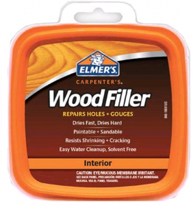

Hi Sid. There is a really nice product for wood made by Elmer - it is wood filler putty. It comes in different packages (small. tubes, large) and different colors. It is drys very fast, sands smooth and stain friendly
