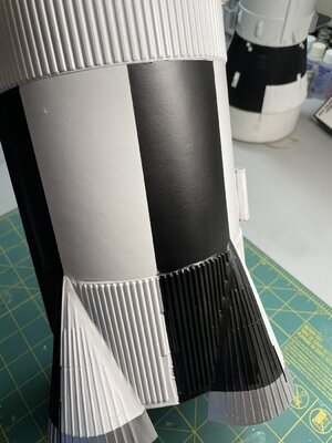

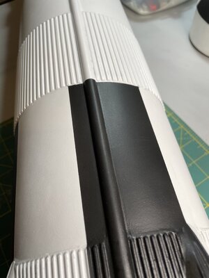

I’ve had good outcomes with Testors Semi-gloss Black for projects where the original subject was likely painted with gloss paint. There’s something about the vagaries of scale that makes straight gloss paint look unrealistic on a model, however, yet flat paint isn’t quite right either.
I’ve attached pictures of an Apogee 1/70 scale Saturn V model that I just sprayed with a 50/50 blend of Testors semi-gloss black and Mr. Color Thinner. (Yes, the Saturn V is meant to be launched. No, I haven’t committed to launching it yet. :) )
Btw, the painted surface is mostly cardboard tube. The corrugated parts are vacuum formed styrene.
