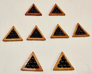

G'day Paul, on most English Ships there were racks along the side of the gratings and also they used a triangular
shaped holder that went between the guns,
These are three different sized cannon balls for my Bonne Homme Richard cross section,
Hope this helps you,
best regards John,

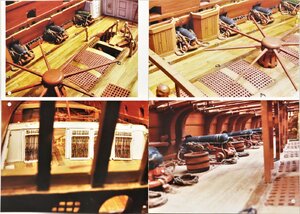

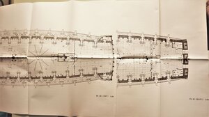

also the french navy used often the triangles for temporary storage of the balls during the actions. Especially on the upper decks, where they can be removed, when not needed.
Shown on several drawings sets from ancre, f.e. the 74-gun ship
or the L´Arthesien
you can find them also on contemporary models (here also the L´Artesien)
Sometimes they had also small racks mounted over the waterboard - here the Saint-Philippe

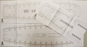

or the L´Arthesien

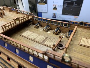

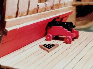

As you can see in the picture below (My ZHL Soleil Royal) - where are the cannon balls stored on deck? In the kit there is no information. Can anyone shed some light on this?
Try building [ brass monkies ] out of small scraps of wood, toothpicks, match sticks split down the middle, arrange in a square, or triangle use copper, or brass paint, add cannon ball's, now you have "the ball's in brass monkies " one monkey per two guns, not to close. hope this helps!

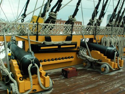

They were not stored on deck but on a lower deck in long horizontal shot racks and brought up as needed. To store them on deck would invite rolling around dangerously in any seas. The story of brass trays (monkeys) holding them and contracting faster in cold weather spilling the stack of balls is discredited as a myth. The boys who carried powder and shot up were powder monkeys, the guns were also called monkeys, and the curved rear lever on the breech the monkey's tail....the place was overrrun with monkeys....so as they look neat I would make some brass monkeys and stack the balls in them on my model but it is not historical, the story is so much "monkeys". This pic shows some stored on the gun deck for immediate use
