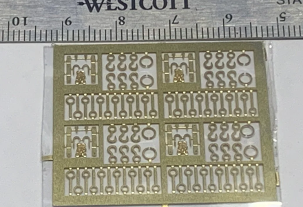

another supplier would be @Dry-Dock Models & Parts - they have very good photo etched parts for the complete gun carriages incl. the capsquares
These would look much better than the Artesania

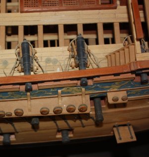

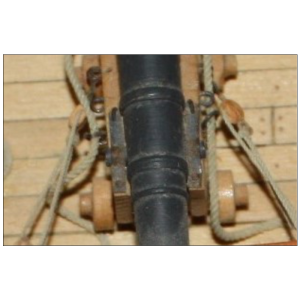

Luckily there are choices that work well for the cap squares. As the cap squares were usually iron, dark grey or black construction paper or thin card stock works well at our small scales. Brass pieces such as those in the photo above are obviously much stronger but the paper or card stock looks very good and will last. Card stock cap squares in the photos below have held up well on this 20 year old 1:48 scale model below of Inflexible (64) 1780. Just cut the black paper or card stock in strips the proper width bend it and glue into place on the carriage brackets. If you try cardstock I have only found it in white so I cut the strips then paint one side and the edges first. Once glued in place add the hardware using copper or brass wire. Copper is easy to work and can be blackened after it is in place with a touch of diluted liver of sulfur which will not stain the cap squares or carriage.
