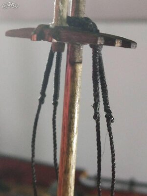

Hi friends. Would appreciate some help please with my shroud pairs. I noticed that some folks have whipped/seized their shroud pairs to strengthen the ropes where they wrap around the masts. Looks like around 30mm long for each shroud. This is in addition to the seizing to secure the shrouds tight against the mast. I have tried different ways to wrap the whipping around the rope, but none of them come out clean the way I want. The whipping just seems to unravel and refuse to behave. Can someone share their techniques how to do this properly please?

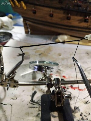

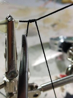

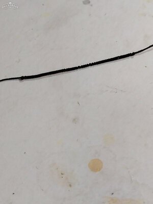

Hi @dearg .... lacking authoritative information on the proper whipping/serving technique, I did the most logical method in my simple thinking...stretched the shroud over my third hand tool, then just started to wind the smaller whipping line..putting a dab of CA glue after the first few turns to hold the line in place..I also applied CA glue at the end to secure the line...also made sure that my ropes were adequately run through the beeswax in order to be more manageable and hold its shape..I served around 30mm on each side of the the shroud (total of 60mm)...to help keep the whipping turns in place, I applied diluted white glue very lightly. In the end, it was not perfect as there are uneven spots, but good enough, I think.

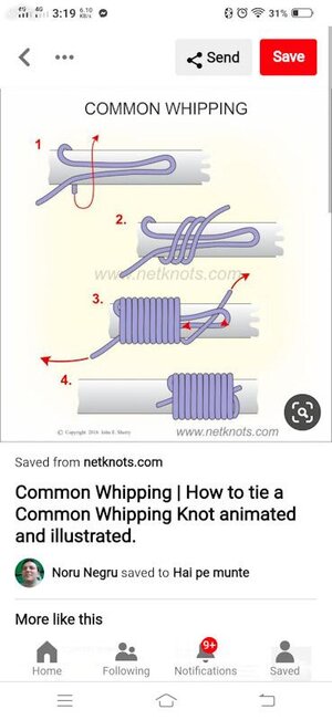

Oh, I also tried to use the classic serving method below, but I found that the served portion was just too long to properly pull the strings through in the end...an alternative I guess would be to break up the 60mm into 3 sections of 20 mm each. This will yield a more uniform winding result.

The whipping method is designed for a short length of line coverage by the serving. If you make many wraps beyond a certain length, the friction will not allow you to draw the opposite loops under the wrapping line, and it will break. Instead, simply tie the end of the serving line in an single overhand knot, secure it with a small amount of glue, and begin wrapping the shroud line. The shroud line should be as taut as possible, secured at both ends. With practice, your serving will be wrapped tight. While doing this, my hands often get tired, and need a break. As Warrlight said, you can apply some glue to anchor the serving to the shroud line, and when it takes hold, you can release the serving line and rest your hands. When the serving is long enough, make the last pass of the serving line into a hitch and secure it with glue. Then admire your workmanship for a few minutes, if not a few hours. ;)
