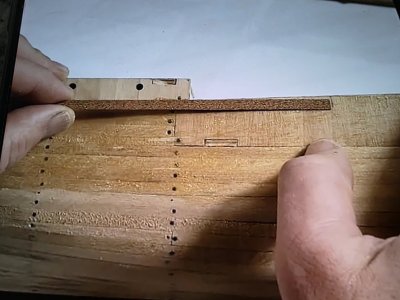

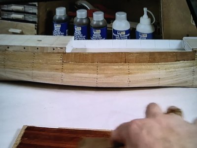

Also depends on the kit. Here is an example of The Endurance, by OcCre. You are force to apply a second planking due to the way the kit construction was developed. See short video and images to understand.
