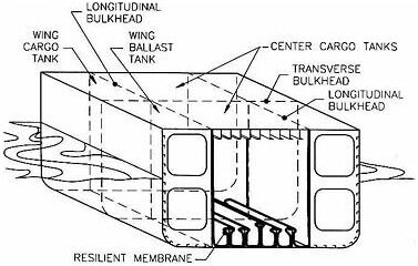

Just to remind ourselves, and to help with context, in period ships the walls installed abeam (side-to-side) in a vessel's hull were called "bulkheads.” “Wing” refers to that section of a structure on the outer edges of side-to-side or abeam structures in a ship’s hull. Thus a wing bulkhead is the outer section of a multiple section side-to-side bulkhead that is next to the hull itself...for example a three section abeam bulkhead had a right wing, center section, left wing. The term is more commonly used for modern era tanker construction such as wing ballast tanks or wing cargo tanks. A wing ballast tank is built into the outer hull and a wing cargo tank is the outer tank where multiple self contained cargo tanks are constructed side-to-side…left wing tank, center tank, right wing tank. My apologies for going back to descriptions that we are all familiar with but I think redefining the context helps.
Maybe a picture helps…this is a lower hull cross section of a modern era tanker…note the “wing” cargo tank and the “wing” ballast tank. Thus generically “wing” refers to structures on the outer edges of a ship’s hull.

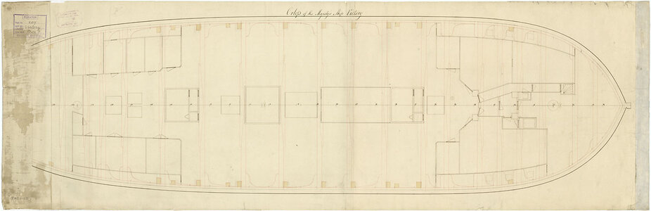

The "parted off" made me think that there may be a bulkhead running fore and aft to give access. That could be a "wing bulkhead". I would think something like that would show on he plans and the Discovery 1789 ain't got um.

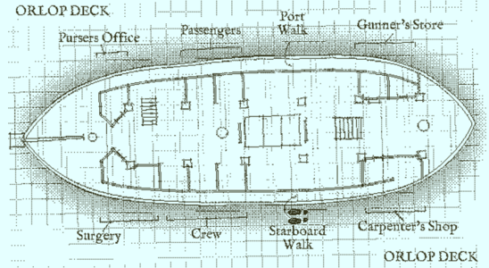

I was reading a contract for the HMS Echo 1782 and it was mentioned in there. Other that that I
know nothing. It was just a curiosity thing. It may have something to do with the "carpenters walk" whatever that is?

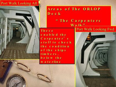

The Carpenter´s walk was usually at the orlop deck. These enabled the Carpenter’s staff to check the condition of the ships timbers, below the waterline.
So a small theight walk at the outside with free access to the frames and partly the outer planking - so he could check, if there are any not watertight areas.
Often it was also named only "starboard walk" or "port walk"
HMS Victory
