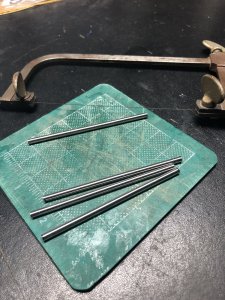

At first, I decide to open a new log, but quickly realize that it would be fair to continue with Maarten post. Alright, enough intrigues. I promised to post my own made micro chisels, and here we go: I bought a 1/8 (3.1mm) 1-0 tool steel here: https://www.onlinemetals.com/merchant.cfm?id=148&step=2&top_cat=1354 It comes 36" long and 3pcs.
I cut 5 psc (80mm each) with my jewelry saw

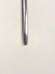

The next step is to shape up. I made flat and half round from the video tutorial and 'V' shape my own. With two left blanks, I will go a straight chisel and ...don't know yet.

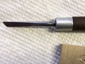

...and tried to make a handle out of maple, didn't finish as I don't have material for the tenon. Also, I need a butane torch for hardening. Will look for both tomorrow in Lowers. The next step hardening and sharpening

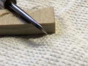

Mates... this will be the last post in 2018 as I continue with my micro chisels. I got a fiasco with my 'V' shape when trying to sharpen it. It is a special technique I have to learn. But I replace it with a square chisel to make 'TRIO'. I am impressed with the results and speed you can make them. I am sure I will make other shapes and smaller sizes. If you have any questions please let me know.
