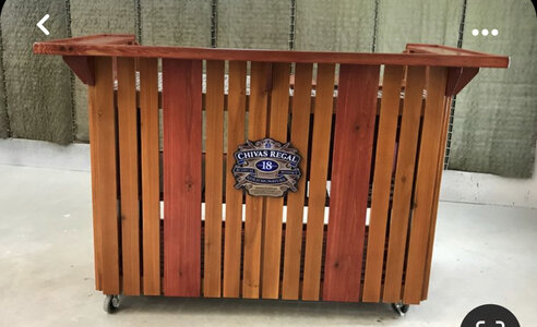

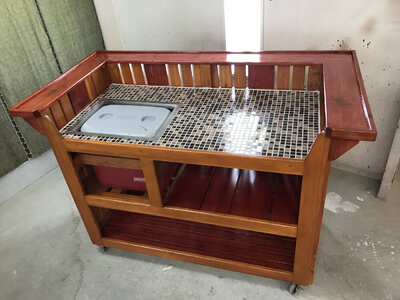

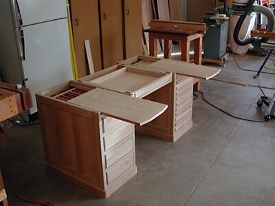

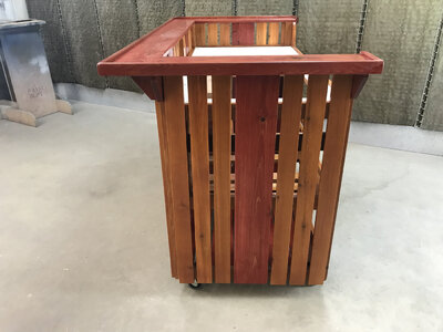

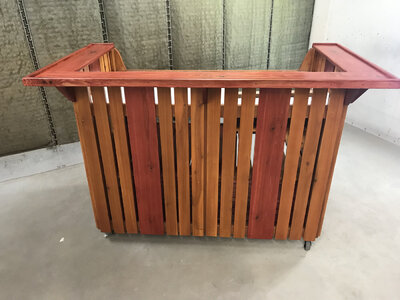

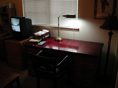

I too am retired. A lot of my woodshop was purchased years ago. Everything I bought serves a purpose. Model building, for me sometimes calls for other tooling and techniques. I also build big stuff.
