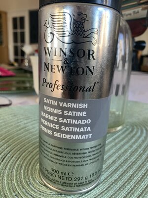

For final finishing I use that satin varnish (see attacment)also it gives a slight wet touch to the varnished wood not covering the wood pattern.Also good for UV protection.don’t apply it to the ropes of the rigging because then all loosen fiber and dust on the ropes become visible like the skin of an hedgehog.(also valid for other varnishes).I also use it to refresh long in dust standing decks where dust in unreachable corners cannot be removed ‍☠️
