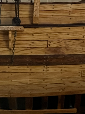

the wood called "pearwood" used in kits is not pearwood not even remotely related to European pearwood or what we call Swiss Pearwood
the wood is actually African Pearwood also referred to as Moabi or Djave Nut. scientific it's Baillonella toxisperma

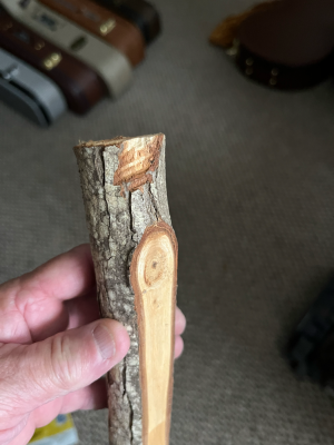

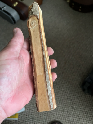

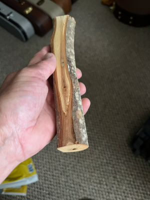

true Boxwood is not even a tree it is a shrub and only small pieces can be obtained the biggest piece i have ever had in my collection was a log 4 inch diam by a clear 9 inches long. so i highly doubt these kits that claim are boxwood are not boxwood not even related to true boxwood.
once i figured out the cost to build a 1/4 scale frigate out of true boxwood. At the going rate the wood along would have cost $3,500.00
so how can you buy a "boxwood" kit at $1.200
