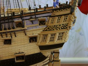

you can see boxwood and pearwood are close to the same color. Boxwood has no figure as where there is some figure to the pearwood. When planking a hull boxwood will give you a mono tone even color where as pearwood will give you shades of color so you can see individual planks

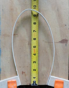

peawood will bend like this and no way will boxwood bend to this extreme

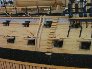

light colored wood will make all the seams show up

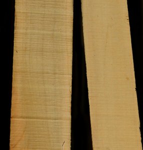

also basswood is a very very very soft wood you can look at it and it will leave an impression. where boxwood is much harder and keeps crisp edges. they look similar but properties totally opposite each other
