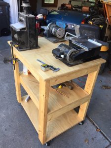

I found these simple plans for a roll around stand for bench top tools with plenty of storage space underneath to boot. I keep my Byrnes equipment on it. It's in the garage for summer, but soon will go into my basement shop. Just a few 2 X 4's and some plywood. the most expensive part is the casters! I plan to build another one because it has proven so useful. Takes an afternoon to build. Stationary full sized power tools make it a snap, but it can be built with hand tools only.

Plans: https://www.canadianwoodworking.com/plans-projects/rolling-shop-cartImg_1060.jpg
This movable stand looks realy useful.
