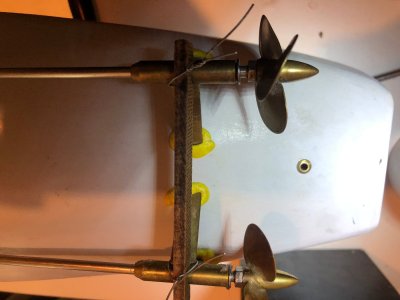

I have a couple of photos of where the hull is at now, I've just resin(ed) in the propeller tube supports,the tubes to hull and the rudder tube has had some reinforcing done to it.
As the holes I made to take the supports and tubes were a little too big, I tried using plasticine to block up the holes on the underside to stop the resin falling through.
It seems to have worked,it's the yellow stuff in the photos.

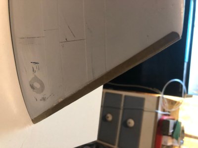

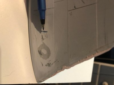

I originally bought the hull from APS models here in Australia as a CA class hull,but after I started collecting photos of CA class destroyers I noticed a (very slight) curve in the bow, and also the anchor hawses were too far forward.
I tried to straighten the bow with Auto body putty (bondo?) but it wasn't very successful so that's a 'rework' area.

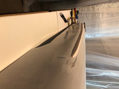

In the last photo is an idea i had to get some straightness into the bow,by using a strip of brass angle which I can then fill behind with AK putty which I believe is similar to Milliput.
Having the brass strip on the bow will also hopefully protect it from the 'dockside' when I take it for a sail.

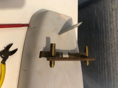

The tiller post was a bit too short to cut a key way into, so I ordered another rudder which is lighter than the old one,has a longer shaft and has a tighter clearance to the rudder post support.

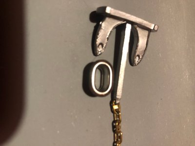

I've put on one quick coat of single pack primer and have started marking out the position for the repositioned anchor hawses. I couldn't really find any ready made hawse outlets so I am going to use water outIets which are a similar shape to the outlets. It was difficult to find photos of the actual outlets because in all of the photos the anchors are 'up' and obscuring the view of the outlets.
