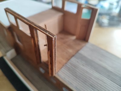

The cabins are modeled with Inkscape from photos and also laser-cut from 3mm plywood:

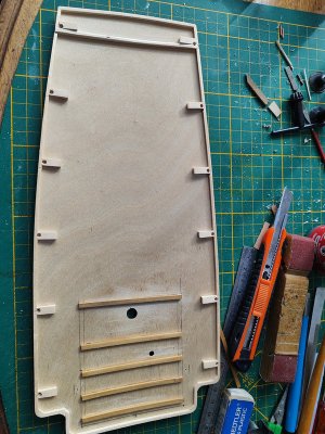

Everything is removable. This photo shows all the elements at this stage of construction.

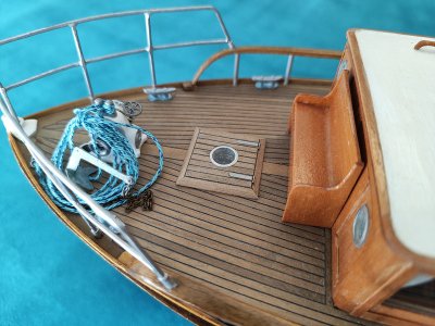

The windlass is built on a 3D printed base to which I added brass, wood, nails, paint...

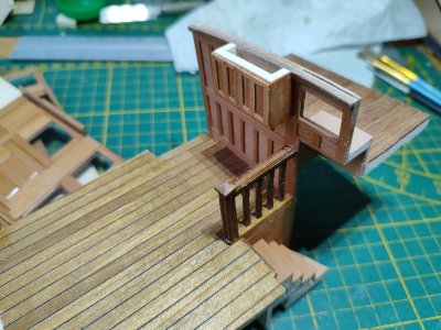

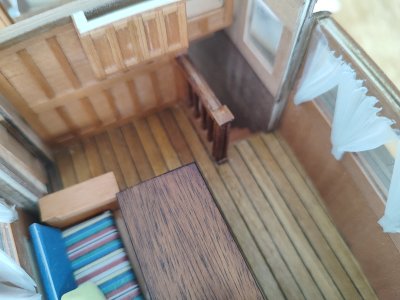

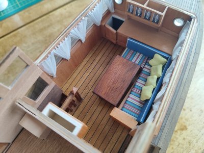

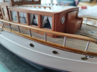

Now the curtains and the staircase leading to the lower level are finished:

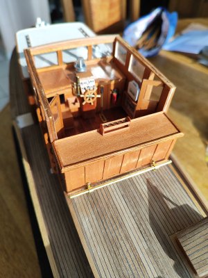

The cockpit is still very empty:

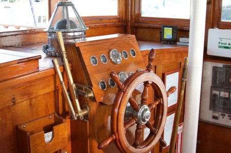

The goal is to obtain something close to this:

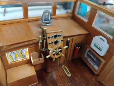

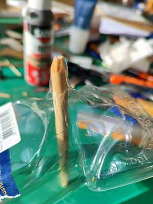

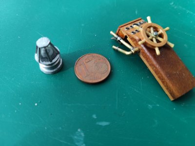

Since I couldn't find a 6-spoke steering wheel commercially available, I had to build it myself.Vida Mia 0060.jpg
Here's the result. The compass was made by thermoforming a sushi wrapper.
The stained glass is a decal. I made it using special paper that you put in the printer. This is the stained glass window that you can see from the dining room in my previous post.

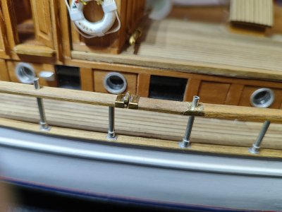

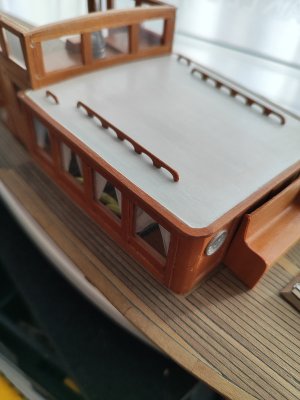

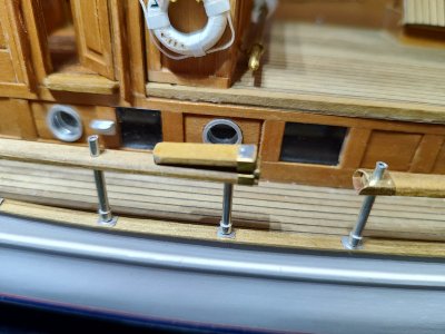

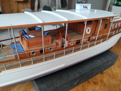

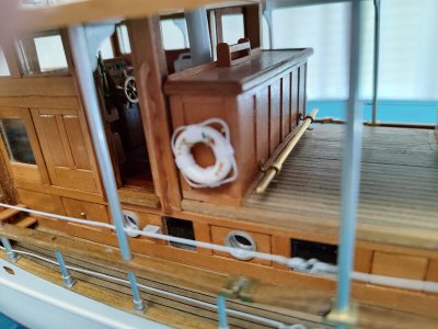

The front cabin roof is installed. Everything is removable. The assemblies are made using micro-screws, like those used in eyewear manufacturing.
The handrails are laser-cut.

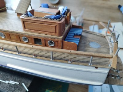

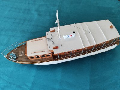

Hello everyone,
As promised, here are the next photos of the construction.

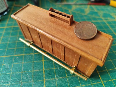

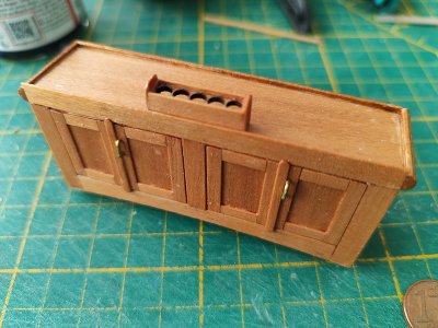

Here is the bar counter with the bottle rack. The holes for the bottles are 3mm and laser-cut.
And the other side:
And here at its place:

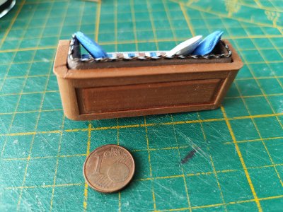

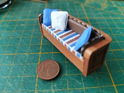

One of the sofas in the rear lounge:
And the other side:

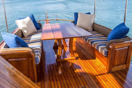

Now the real lounge:
And the model:

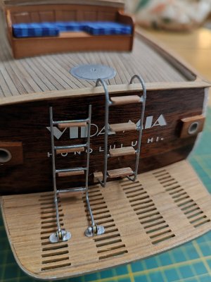

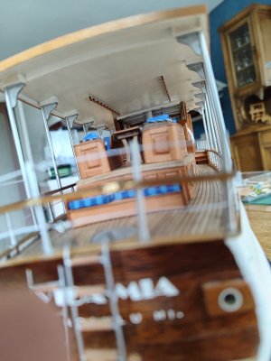

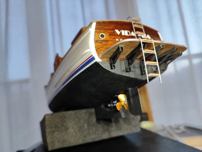

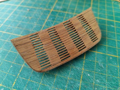

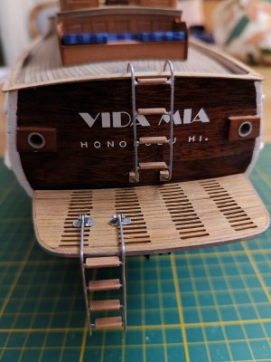

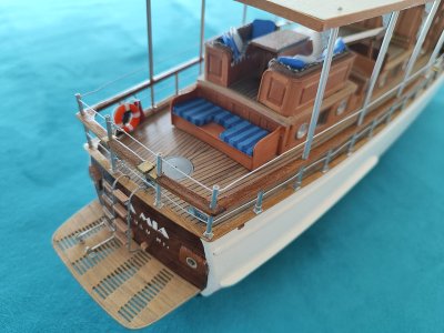

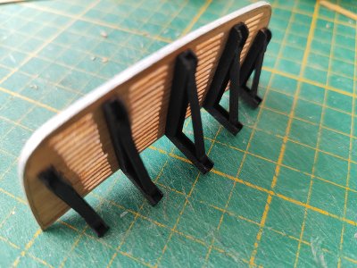

The construction of the bathing platform using 1mm slats:

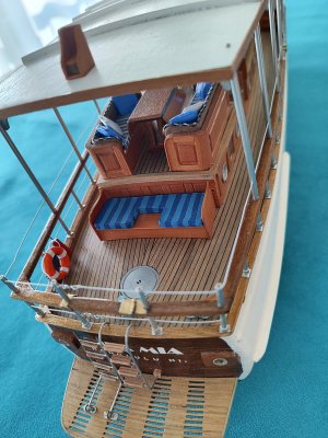

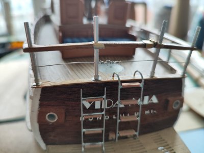

The bathing platform, once installed with its ladders:
And finally, two photos of the actual platform:
