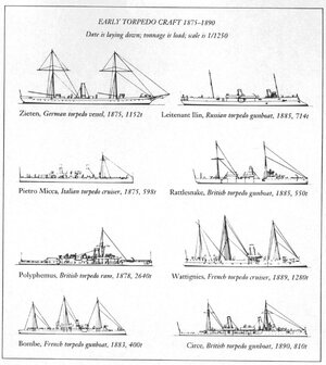

These elegant early torpedoboats and their Experimental Designs to get most out of these small steamengines
using different designs even with fore'n'fter sails to stabilisize them during their way through waves and wind staying in course.

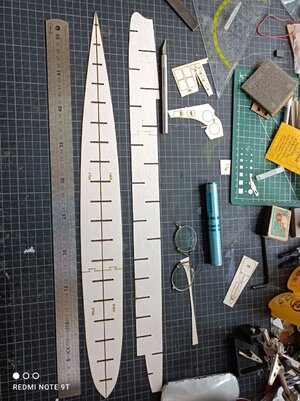

So I did start this 1/100 double kit by YG-model some weeks ago.
The kit shows an interesting whaleback hull with a
free standing grating about it to give the big ammount of water a fast way to leave the boat's topside in the ocean areas.
By this giving the crew of this wet vessel a nearly "dry" stand. And to me the trouble to get these square openings open....
The two torpedoboats are from 1898 FORELL in white and LOSOS in light green both Kits with LCparts for less than US$20,- to get at all something to do for me as my admiratity told me.

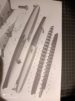

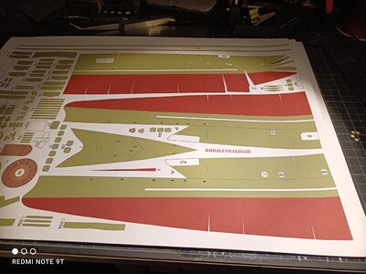

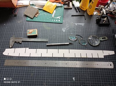

The hull's skeleton is plastered with a quadro part surface so only four parts so do form the hole surface I am affraid that I cannot manage to preform the 160g/sqm cardboard. So I do think I am unable to glue these quartett of cardboard without gaps so I will have to putty the notches and spray the model in very thin layers white. But then the paper may get too wet and sink in between the bulkheads. So I need to add some further glueing/resting areas to the given skeleton.

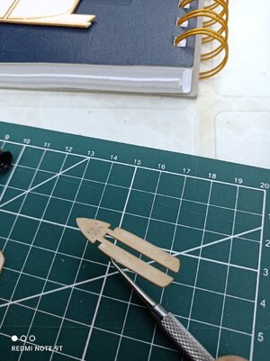

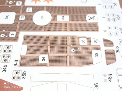

The back deck shows the very little but delicate detailling and a finde railing. Is this (wooden?) boom to the stem a reminiscence of a speartorpedo?

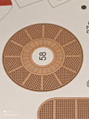

Here the beautyfull shape of the wooden grating arround the 47mm Hotchkiss QFgun. What a big pitty to keep it enclosed.

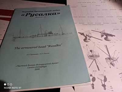

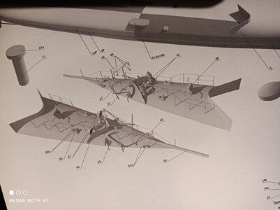

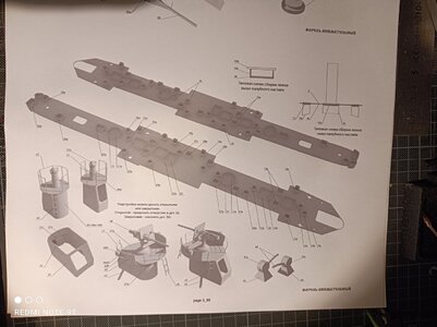

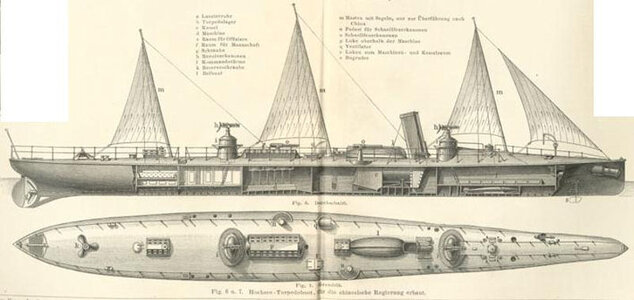

Picking out details from other Russian plans have me some Help so I am able to understand
the rough 3Ddrawings of the YG-model's manual and finescale the kit further more.

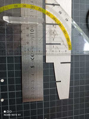

But back to the FOREL kit itself: It is just 168mm in length on moulds...
and does look besutyfully slim fitting to my cutting matt.

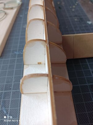

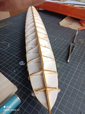

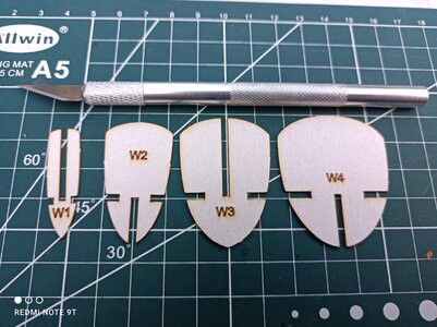

Here the bulkhead N°1 on a dentist's tool hardened by superglue.

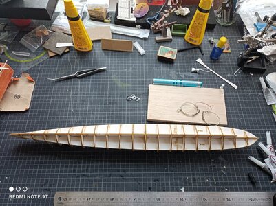

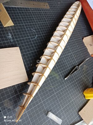

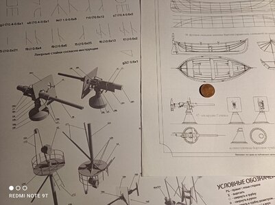

The tirst four bulkheads lines up may hopefully give you some impression about the amount of water being flushing the deck forcking the bow down into the water. So the whaledeck was the right answer to this problem of those small high sea going vessels (b.t.w. the lines plan of this old torpedoboats does mimikry the WWI German u-boats very well.)
Here the branch infront of the windows (mostly closed due to the dustbins aside). And in the lower right Corner you can see what amount of superglue was needed for hardening the edges.
Here the hardened edges by use of superglue die to make them able to be sanded - WIP.
On the very last bulkhead you can see how much of the horizontal deck will have to be sanded away.
Her beautyfull underwaterlines appear very well in this photo.
