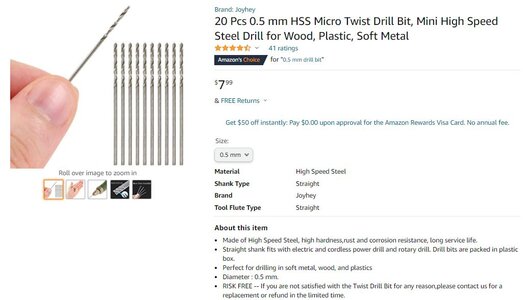

Do you guys know a source where I can buy let’s say 12 micro drill bits of the same size, in this case .5 mm?
On Amazon I’ve bought sets of micro drills but I need more than one of this size.
Thanks
John

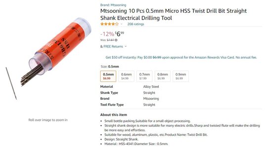

Has anyone found any small drills such as 0.5mm that will actually drill steel or even hard brass?
Most of these shown above just blunt if they get anywhere near the hard stuff!

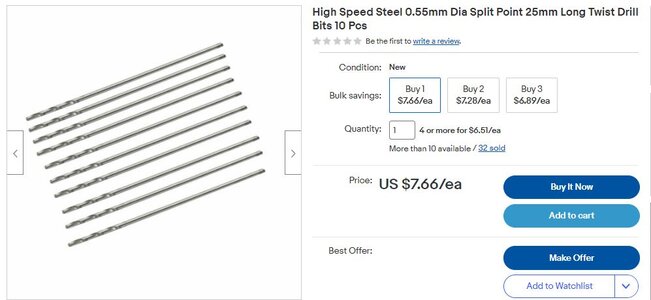

The tungsten carbide drills I listed will drill tool steel. (There harder than Superman's knee caps) The down side is that they are very brittle and break if you are hand drilling or using a Dremel. Any side thrust and they will snap. The other drills are listed HSS (high speed steel) which indicates that they are made of high tensile tool steel.
The drill shape shown in the video listed below are well suited for drilling brass and mild steel.
