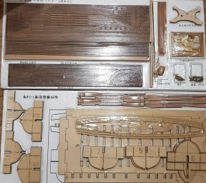

All the supplies timbers etc. are first quality and these timber are equal or better than any other high end kits available.
I'm using over 30 years of experiences, comparing and using other brands. The plywood bulkheads are again the highest quality and this is the first kit that I have brought, that showed a laser score line to where each bulkhead have to be beveled. These score lines are very, very accurate.

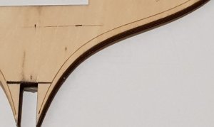

A close up of the scorched line to show the beveled edge. Every bulkhead has this, even the ones in midship where there's only a minute difference. I only discovered this when I scanned the bulkheads into my computer and it was only visible at 300 percent enlargement.

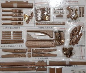

The deck furnitures are out of this world. Everything is included, this is one huge advantage over this kit compare to all the other kits that I have used, over the years. Not only they are supplied, the amount of details on these parts are far superior than anything else on the market, in my opinion.
An example of the decking furnishings, they are still in the protective packaging ready for me when I'll use them.

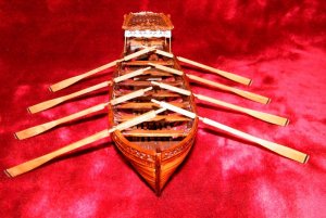

Oh... there's one other positive amplitude to this kit. There's is a kit within the main kit, that I almost forgot to mentioned. It's the incredible ship's boat. There is enough in this mini kit to make you busy for week and weeks.
The unopened parts for this mini kit.and after a lot of work for weeks you will get this...
This is the model made by Neptune of the mini kit of the ship's boat.

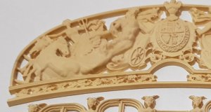

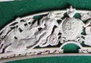

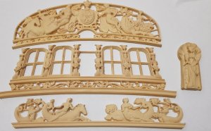

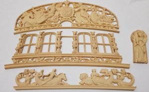

I for one feel, the amount of carvings on this model, it worth to get the highest carvings.
The above is photo from the site of Taobao. And below is my boxwood version, WITHOUT any cleaning.
And here is the all of the carvings on the transom. There is a market difference compare to the photos on the Taobao site.
