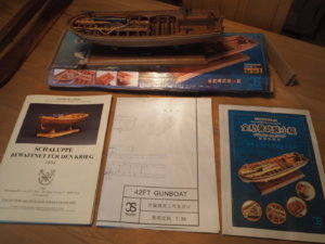

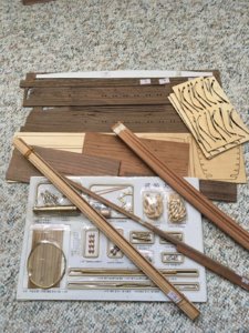

Hello, so my first ship model is going to be built (i hope) from the kit was given to me, here is link: "Chalupa 1834 L 14 Inch 360 Mm Wooden Ship Model Kits".

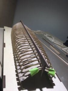

From the first look, some parts don't fit and plywood used for ribs splits a part.
Not easy to bend plywood planks, they split too..
For sure making this boat will take time, I can only spend a few hours a week. Will be some readings happening before every next step. I know how to work with wood but I know nothing about ships :)

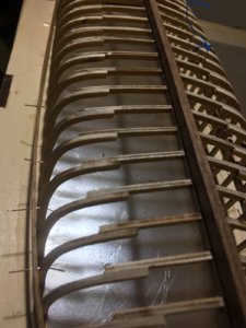

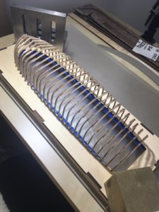

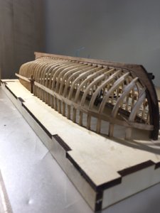

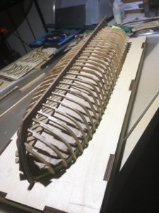

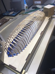

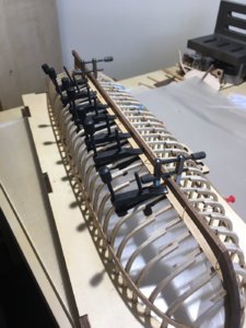

Easy part is done, 30 ribs are in place!
Thank you Maarten,

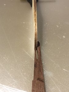

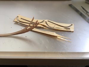

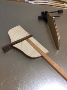

Thats what I thought. In the kit instruction they put plywood planks as a main layer and pear .5 veneer planks on top. I'm taking a challenge to use what I've got in the kit even if its going to go slow with the "pain and suffering". I don't know WHY would ZHL make kit that way. After I tried different technique, I discovered that steam will soften the glue used in plywood to the point of splitting or shifting the layers. Then left under pressure glue settles back keeping layers together "like nothing happened"

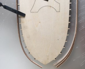

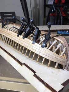

I successfully bend three planks to very close shape ( good thing they put way tooooo many in the kit :) ) Two of them will go on the first line, third one I put to the test to make sure glue keeps layers together. Left plank was banded using steam and the right one was boiled, where glue lost the properties.

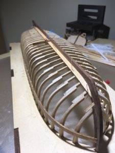

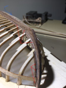

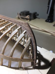

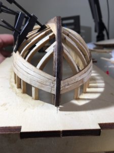

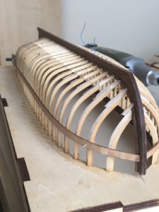

Finished keel by adding groove, don't know the right name for it. Also, I added additional structural support (not part of a kit) to have wood grains in the "right" direction.

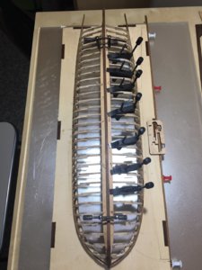

Getting ready to glue the FIRST plank
Made this little jig to help with making holes:
Hi Yuri, Hull planking runs down the hull of the ship. Where it hits the bottom keel, it needs to 'slot' into a groove so the planking lays flush with the keel. Bearding Line is higher up the center keel and represents the top edge of the cut. The second is the rabbet line, which is the bottom edge of the cut.

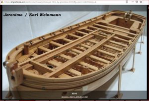

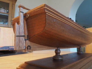

Hello Yuri,
see my construction report here in the SoS forum.
Can be of help in building your model.
Karl
To make it easier for you to find here is the link:

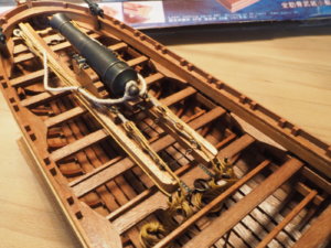

Very nice work.
I too like those little black clamps. What are they and where did you get them please?
EJ
Hi, Try searching online for "toolmaker clamps". I bought them in 2010-ish from LeeValley.ca, Small Machinists' Clamps - $5 a pair (they don't sell them anymore). My clamps don't have manufacture stamp. Back then I was able to buy 30mm and 40mm, now the smallest 2 inch i'd get from BusyBeeTools.com
