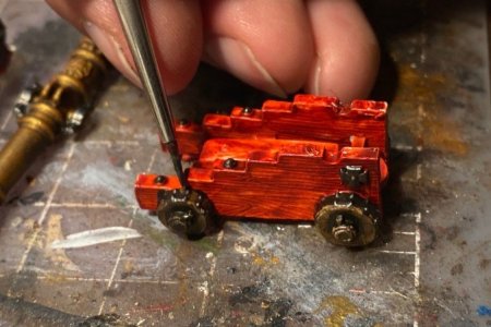

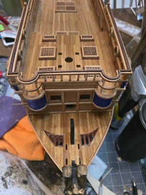

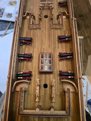

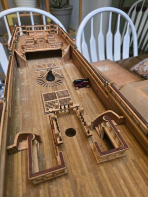

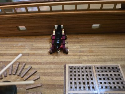

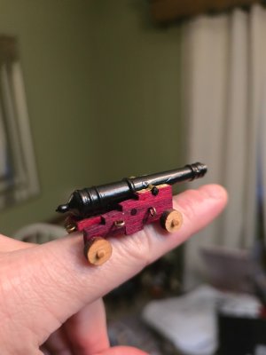

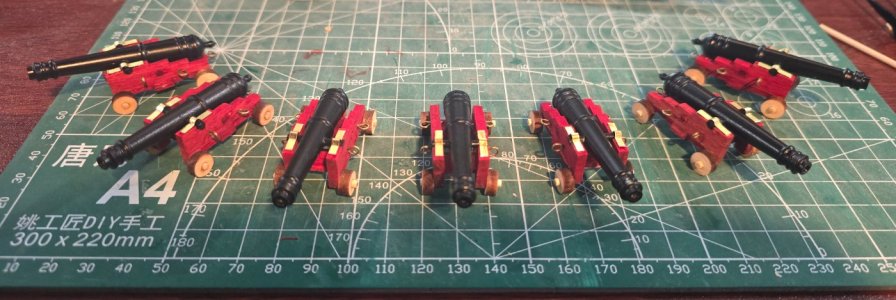

I love the way this color turned out on the gun carriage pieces. This is one pack of the old formula (pre 2010) crimson rit dye I had laying around, plus half a cup of acetone. I strained the mix through a coffee filter to remove the dye crystals and added half a cup of oil based polyurethane.
It's just dark enough for my taste and will be a fantastic contrast to the rest of the deck.
That's nice. I love the wood grain showing through and the color is perfect.
This whole dye with acetone procedure is new to me. You said it was ore 2010 dye. Would this work with the current dyes on the market? Is the mixing with the oil based poly necessary or could it be poly coated later so that glue would still work?
I don't see why you couldn't do this after assembly. Rit still makes this color, but I think it needs to be dissolved in mineral spirits or paint thinner, I can't remember which one. Honestly, the poly is so thin in this mix, you could probably just do acetone and dye and get the same look. I've been using CA glue for this build and it sticks to anything and everything.

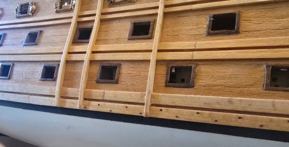

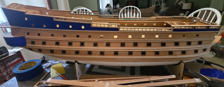

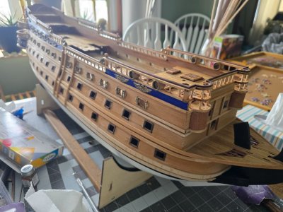

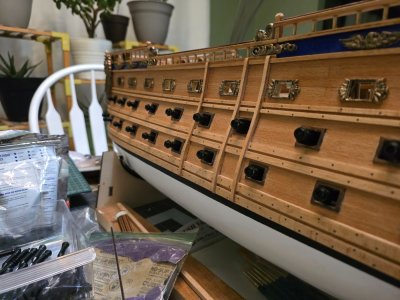

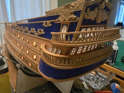

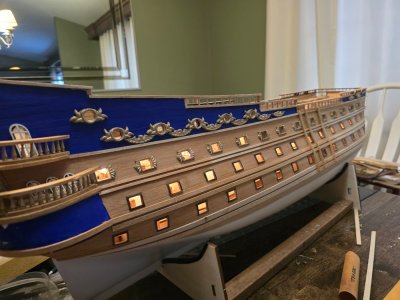

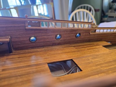

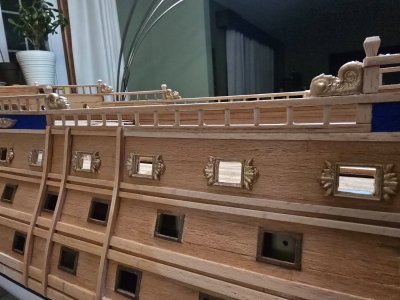

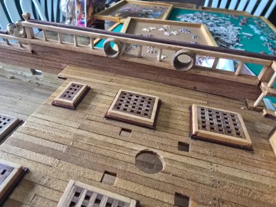

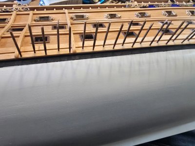

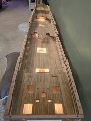

I installed the pilot doors(?) on both sides, and the small deck/roof combo on one side. Hopefully I can replicate it on the other side, these tiny railings are difficult.
