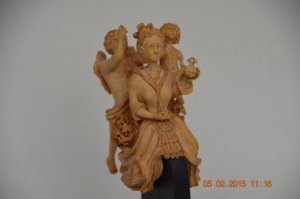

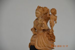

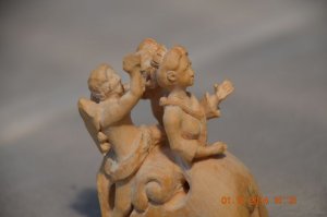

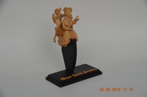

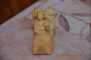

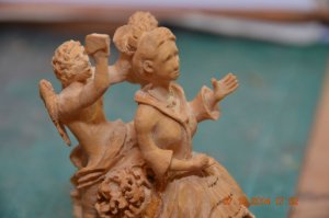

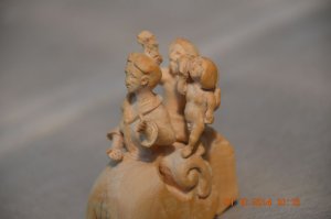

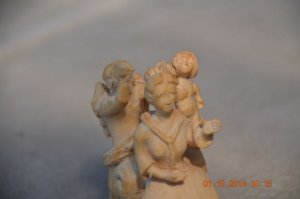

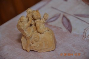

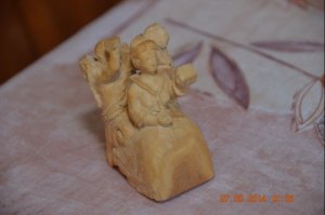

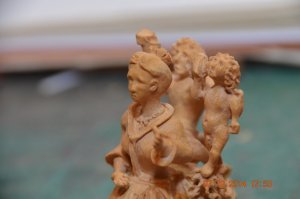

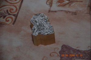

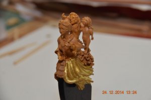

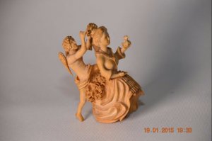

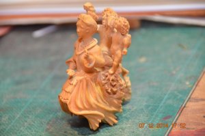

I am just too lazy to make a real building (carving in this case) log so here are a few pictures in sequence. I also built the whole ship and made the carvings there but I also wanted to carve the figure head itself to a bigger scale (1:20). The basis was the Bellabarba-book of the Anatomy of the Ship series. The material is European Boxwood and the tool mostly used is the Marathon micro motor rotary carver. To finish the carving I used self-made scrapers to smoothen the surface.

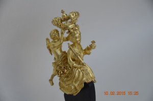

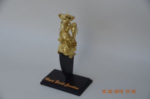

As the original ship's carvings were all gold leafed I made an attempt to make the figure head the same way. I used 22 carat gold leaf and after a few unsuccessful attempts I managed to achieve a bit better result with a German seize, although I am not happy with the result. The carving just looks better without the leaf.
There is no text but I hope the pictures tell the story. The group of the Queen and the angels are made of one piece of timber and the crown is another one.
