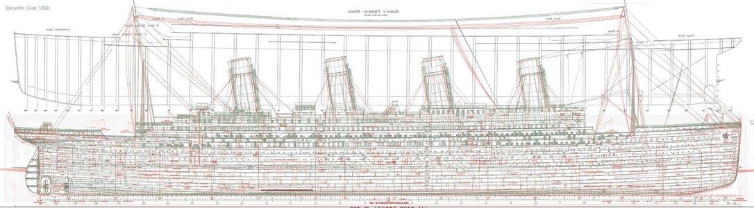

Below the example of the comparison of different plans of Titanic in the same scale

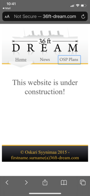

Not sure if this will help. Try this site : http://www.36ft-dream.com/
go to “OSP plans”. There is a hull plan there that may be of use to you.

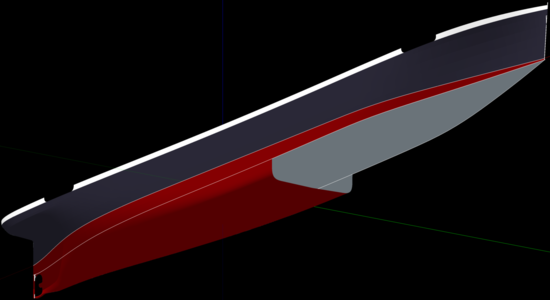

I used the plans from here, the front view is rather lacking so I was only able to achieve the best accuracy on the stern. It got me this far. Above the waterline, the bow curves are actually all straight lines between decks, since the curves in Oskari's drawings don't match up with any given frame (datum) station and are therefore mostly useless. If anyone has any other ideas where to find better datum cross-sections of the bow, since http://www.titanic-cad-plans.com is shut down for sales (permanently, according to the website), I'd appreciate it.

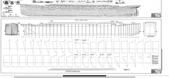

Is this what you’re looking for?
I am not sure, I believe it’s from the Hahn plans. It’s hard to read but the lines are there. If you can enlarge it to the required scale, you may be able to extrapolate the required coordinates by comparing what you already have to confirm the unknowns.
In incidentally, I do have a copy of Bruce Beveridge’s deck plans in 1:400 scale, which includes frame numbers and bulkhead locations in an overhead plan. However I doubt it could help if you’re interested in hull profile bulkhead to bulkhead.
I hope this can be of some help.
Another member had sent me this and I scaled it to 1/350 and had it printed. This is exactly what I needed and thanks for posting it.
The idea is right, the image is really too small though, and enlarging it will only make the pixels blockier. I’d like to access that image at full original resolution for it to be useful. Oskari’s drawings are scalable PDF’s that made it possible to get as accurate to as little as 1/10 to 1/4 of an inch.
