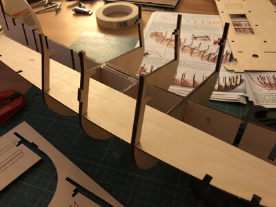

Image 2: Adding the first bulkheads already gives a good idea about the size. As always, no imagination (assisted by a ruler) beforehand compares to the real thing
I would really soon ditch the "instant" wood glue for some fast drying wood glue - the smell was just aweful.

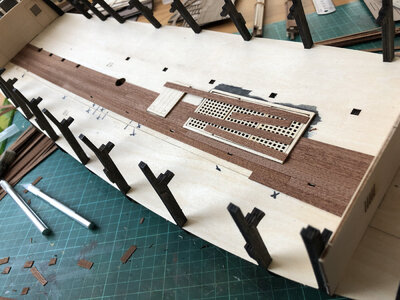

Image 3: Getting the lasercut parts out proved to work quite well with a scalpel so far. Not much sanding needed afterwards. Using the smaller of the two lower deck parts ensured that the frames would be in 90 degree to the middle part of the ship.
What are the decks called on the Pearl? Main deck and lower gun deck? Spar deck and gun deck? I'll stick with main deck and lower deck (as there is only one in this kit) until I know more about it. Speaking of lower decks ...

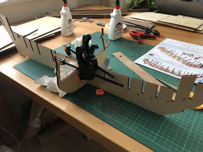

Image 4: The first test fit of the two-parted lower deck made me sweat quite a lot, as there was so much tension I constantly feared sth. would break. I think this was due to (non existant) tolerances in the parts and not because i worked sloppy. Anyway, nothing that some sanding can't fix. Now, I know, I didn't choose the all-scenario version. But I'd still like to be able to open all the cargo hatches (no idea what the nautical term is) right down to the lowest deck. After all, how else could the crew heave up all the rum barrels to blow up the kraken? Unfortunately, there is no "lowest deck" in this kit, but a solid frame.

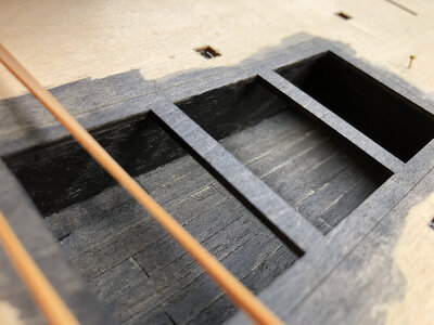

Image 9: Having already put some effort into a little black box at the bottom of the ship, that will likely never really be seen, it is only logical to add some more extras you'll also hardly ever notice once the Pearl is finished: Planks on the lower deck. But, knowing myself, I will enjoy a peek through the gunports or the cargo opening to see a decent deck. Or to be more honest: it would annoy me beyond reasoning to not see planks on that deck ^^
Image 10: As I never finished an H.M.S. Bounty kit many years ago, I have a lot of spare parts to use. The wood color is just beautiful and it makes me almost sad to paint everything black, eventually. But alas, it's the Black Pearl not the Teak Pearl. The dark wood in the ZHL kit is walnut I believe, and its color is way more suited for the black paint. It has more of a grey tone when sanded, unlike the red planks here on the lower deck. After all the goal is not to just spray paint everything tar black, but keep a little of the original wood shimmering through. Anyway, the lower deck won't be lit much.
Apart from the fact that the Black Pearl is a purely fictional ship with some features seen only on much later ships, it originally sailed as the "Wicked Wench" for the East India Company roughly around 1720. So it was probably built in British ship yard. Therefore I decided to use a pattern of four alternating planks (seen in Image 9 on the cargo opening) as this was commonly used during that time. I made a minor mistake along the way, so I'm glad I could "train" on the lower deck before planking the main deck later on.
