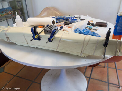

So here we go from the start. First thing was to prep the two halves of the hull for cementing. This was a challenge because it didn't line up very well. I used Six10 epoxy from West System. This is a marine-grade, slow-curing, gap filling adhesive. Great stuff! https://www.westsystem.com/specialty-epoxies/six10-thickened-epoxy-adhesive/
