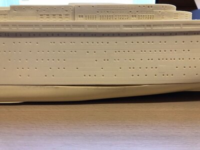

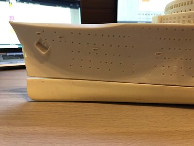

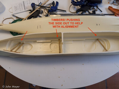

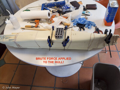

So here we go from the start. First thing was to prep the two halves of the hull for cementing. This was a challenge because it didn't line up very well. I used Six10 epoxy from West System. This is a marine-grade, slow-curing, gap filling adhesive. Great stuff! https://www.westsystem.com/specialty-epoxies/six10-thickened-epoxy-adhesive/

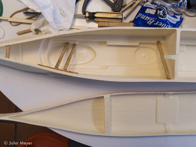

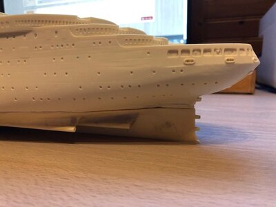

Hi John, the hull looks very nice. I still need to start with the SS Normandie, but one of the biggest challenges is the hull. Both parts do not fit properly. How did you fit both parts to each other?

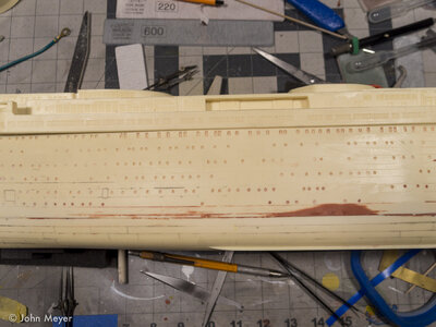

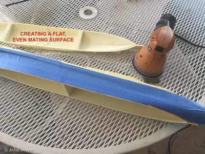

Hi Dennis, yes, joining the hull together was a project in itself. The first thing I did was to sand all the mating surfaces so they're flat and square. I used a long strip of very course sandpaper taped to a flat surface, and power tools!
As mentioned in the instructions, cut notches in the cast-in supports to give the hull a little flexibility. I used wooden dowels and epoxy to push the sides out in places. Eventually I got the fit to be "good enough." I joined the halves with epoxy and lots of clamps and very heavy duty rubber bands.

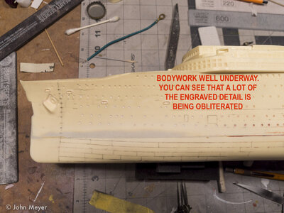

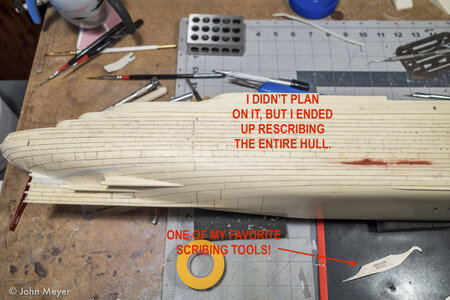

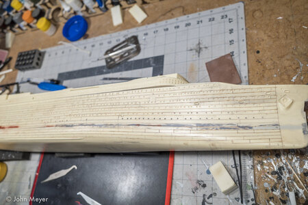

It still required a lot of filling and sanding, and then rescribing the lost plating detail. It's a good idea to rescribe these lines as you go rather than trying to recreate them in areas where they're completely sanded away.
I ended up rescribing all of them.

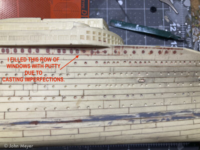

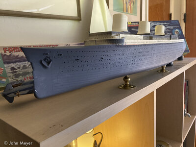

Still scribing and sanding. The row of windows below the promenade had a lot of casting defects so I was thinking of a way to redo them, which is why I filled them in.

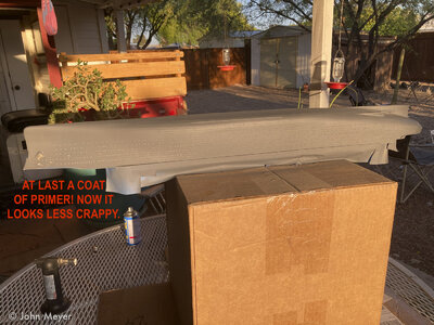

Well, yes: the body work on the hull is complete including all the scribing and (I think) cleaning out all the portholes. So I'm starting on the upper decks which is a lot of cleaning up of the small windows. Then lifeboats and their hardware, etc. etc.

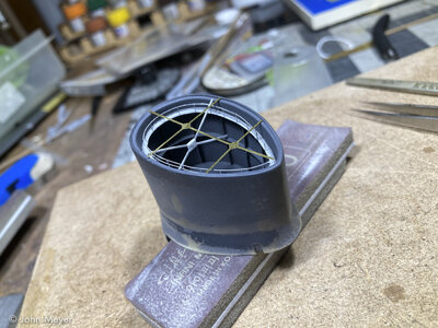

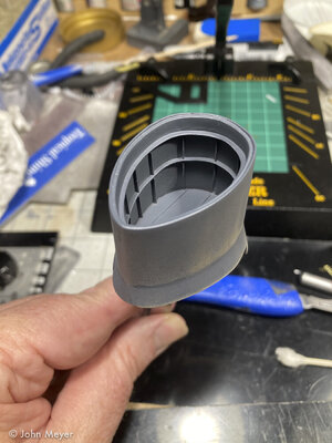

It's been much, much too long! This is about where I left off. I added some internal structural detail to the aft (dummy) funnel that looks kind of accurate...
That is really cool... I bow down to your expertise on making the model so damn AWESOME! And also, I did not know that Normandie's aft funnel was a dummy... interesting, and kudos to you for making it so structurally accurate. I try to upscale all my models but I think your skills have me beat, LOL!
Thanks. I haven't built a ship of any kind since I was in grade school, but I've worked on a lot of difficult and primitive airplane kits. It all crosses over - except for the ship things that planes don't have, like wooden decks!
The dummy funnel housed a dog kennel and I think a children's play area too.
