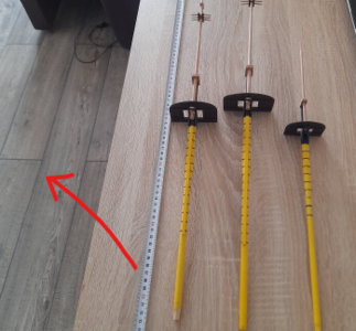

Very clean and tidy work Sasha, well done. A joy to follow. Of course, I see now why your work is so meticulous - looking beyond your perfect topmasts we get to see a work table lined up with precision to your floor boards below, which in turn are installed with a perfectly symmetrical butt-shift pattern :)
