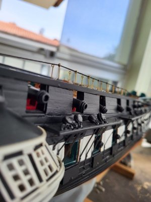

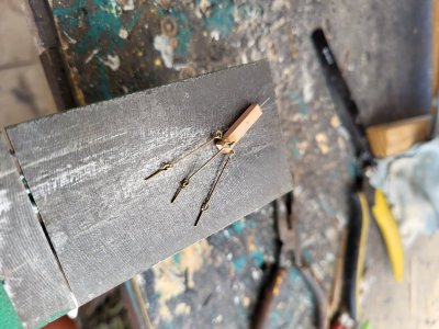

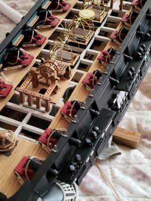

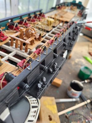

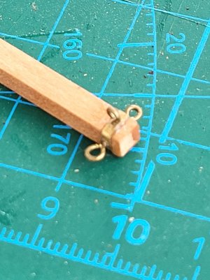

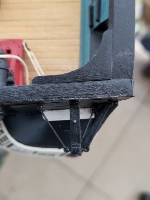

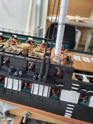

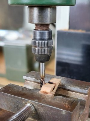

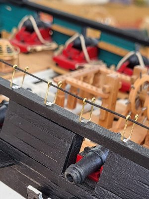

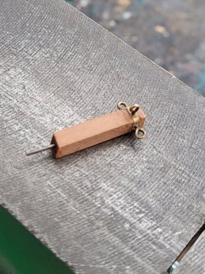

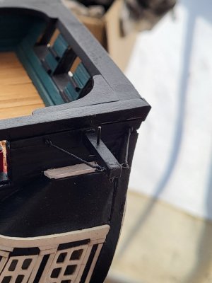

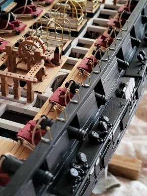

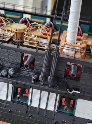

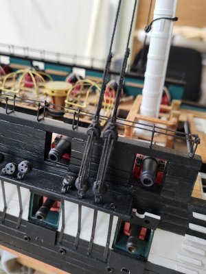

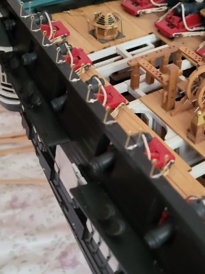

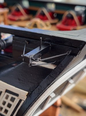

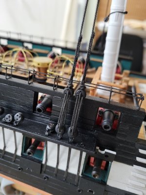

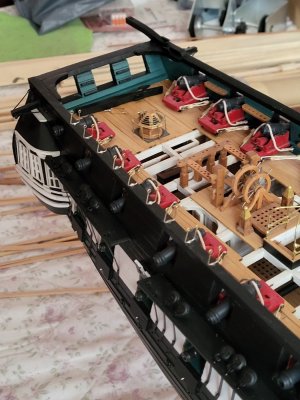

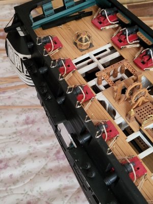

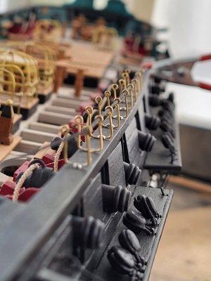

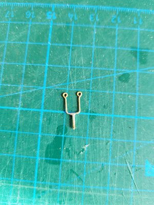

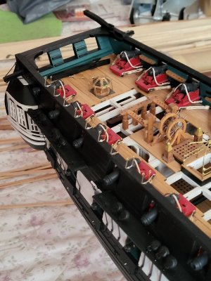

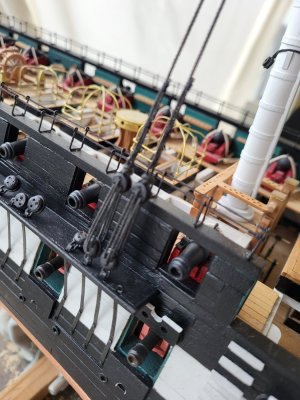

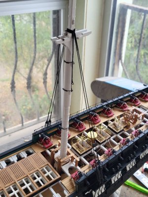

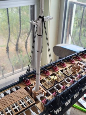

I'm back with a new project—a 1:76 scale model of the USS Constitution. As always, I'll be building it entirely from scratch. For reference, I’ll be using the Constitution book alongside the kit plans from Model Shipways. Although the Model Shipways kit doesn't include details for the gun deck, I plan to add both the deck and its details to my model.
At this stage, my intention is to fully rig the ship, except for the sails. However, since this will be a long-term project, I’ll see where time and progress take me. As always, I welcome constructive criticism, suggestions, recommendations, and general feedback.
The pictures show my progress so far, and I’ll continue sharing updates as the build evolves.
FB_IMG_1710788269355.jpgFB_IMG_1710788273468.jpgFB_IMG_1710788278143.jpgFB_IMG_1710788285888.jpgFB_IMG_1710788292378.jpgFB_IMG_1710788309455.jpgFB_IMG_1710788312727.jpgFB_IMG_1710788316306.jpgFB_IMG_1710788319920.jpg
Thank you so much for the likes and comments my friends.
I glued the bulkheads and put spacers between them. I always put these spacers as a precaution against warping the keel in later stages.
Do you use basswood or balsa wood for your spacers, or does it matter?
I used plywood for the spacers. But you can use basswood or any other hardwood too. Balsa is not a good idea for the spacer, I use balsa only as a filler in the bow, stern or between the bulkheads if necessary. For example, if distance between two bulkheads are too much you may want to fill it with balsa.

Well, this is off to an excellent beginning. I really like your solution to cutting the plank rebate into the keel, stem and sternpost. Also, the use of locating pins to further solidify this assembly. I don’t wave American flags around too often, but I can’t suppress a certain sense of pride in our old girl, Connie. You will certainly do her justice.
