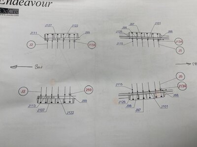

Hi fellow model makers
I am hoping someone is able to give advice on a rigging question. I am currently progressing the rigging on my Occre Endeavour build and in the rigging instructions there is a diagram that would appear to show running rigging being tied to the shrouds (see the diagram below). Unless I am misreading the diagram, is this normal practice, and if so how would extra rope have been arranged e.g. coiled, looped somehow or something else. Thanks in advance for all guidance.
On many earlier ships, many of the running rigging lines were belayed to cleats which were in turn lashed to the shrouds. Sailors knew which line was which by which cleat the line was tied to.
On the Endeavor, the shroud cleats probably looks like this.
The excess running line would be coiled and stowed similar to how your would stow line on a belaying pin on a fife rail.
Here is a good video on how to "coil down".
Example of an early ship, HMS Sovereign of the Seas c.1637. A board which the cleats were mounted on was one method for providing belaying points for running rigging lines.
Example of an early ship, HMS Sovereign of the Seas c.1635. A board which the cleats were mounted on was one method for providing belaying points for running rigging lines.
Thank you for the prompt response and for the super useful information. Might be very fiddly trying to attach cleats to the shrouds in my case.
If you glue these shroud cleats to the shroud and then lash them to the shrouds with thread, they will work well. 5mm cleats are the smallest ones available at the moment. The cleats face inboard. Tying the running rigging line to the cleat first and then routing it up into the blocks and ultimately to the sail or yardarm is easier than tying the end to a belaying pin. Make a bunch of coils to hang from the cleat afterward, and you have a LOT of detail to look at when the model is done.
Shroud Cleats at DryDock Models
Thanks again. Have looked up supplier and can get better cleats than those supplied with the kit. More work but agree it will add detail.
Use a drop of CA gel on the cleat…hold to shroud. The CA gel will take about ten seconds to cure and hold the cleat. Then dress it up with some seizing around the cleat and the stay. Anyway…I found the CA gel to do the trick…
Thanks Jim. Shroud cleats now on order so more fiddly work to do but should be worth it.
