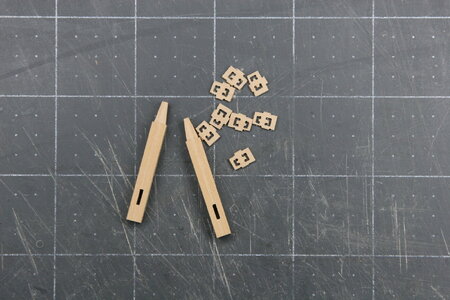

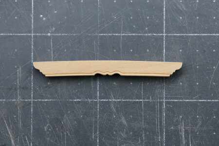

A while ago, before I had completed any research, I had done some preliminary work on the kit-provided main topsail sheer bitts. But when I returned to this mini-project I realized they were unusable. I suppose the biggest issue was that the kit did not anticipate the modeler adding the lower deck. As a result they were simply too short and had a rather clumsy solution to the decorative bitt tops:
So, I decided this was the perfect time to practice using my little mill. Here is a photo essay showing my scratch-built main topsail bitts...

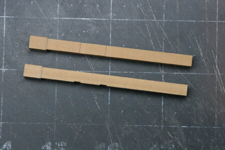

I started with square stock from my limited supply of boxwood:

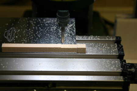

I then shaped the top of the bitts according to the pattern shown in TFFM (Antscherl):
I then added tiny raised panels using some small chisels:
These didn't turn out as clean as I had pictured in my mind ahead of time, but it was not a total failure.
I returned to the mill (along with some needle files) and made the 'arch' that passes across the tops of the bitts:
As you can see, I added a decorative molding/bead along the bottom edge. This turned out somewhat better than the panels.

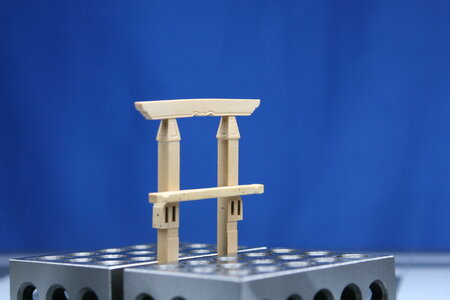

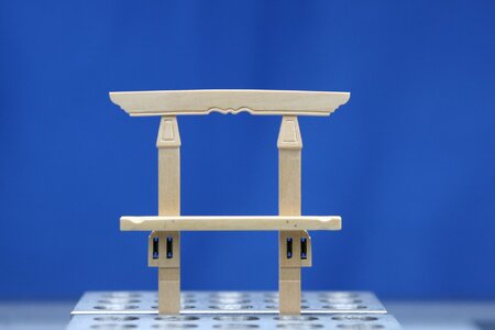

I fabricated a few more necessary elements (the crosspiece, and a pair of cheek blocks) and put everything together:

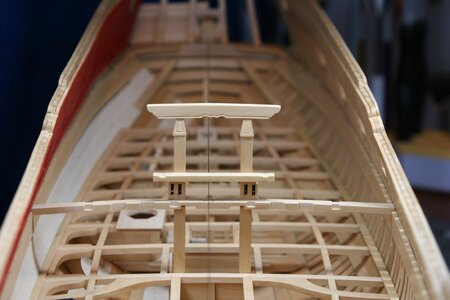

And now sitting loosely on the ship:
This ended up being a fun little project with the added bonus that I gained a bit more confidence with a mill. Next up: the jeer bitts (yes, I am actively avoiding building the upper deck :rolleyes:).
Good morning Paul - “another small update “ :rolleyes:;) . As for those beams- pretty much perfect. I need to get new glasses as I don’t see laminations- perhaps I should use my laptop when viewing work as good as yours….or maybe I do need new glassesROTF.
The photo of the single beam is beautiful. Love your work Paul. Cheers Grant
I'm looking on my desktop, and I still don't see laminations.

It’s immediately obvious that the dentist is busy with good work :) . Paul great jobThumbsupThumbsupThumbsup

Your milling skills become better and better, Paul. My respect! The recesses at the bottom of the arch are very tight.
