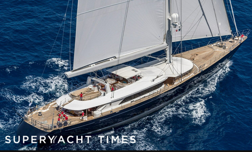

Seven people missing following 56m yacht sinking in Palermo, Italy​
The 56-metre Perini Navi sailing yacht Bayesian has sunk off the coast of Palermo, Italy, with 22 people onboard and seven people still missing.
Local news reports state that Bayesian sank around 5:00 due to a storm in a stretch of sea close to Porticello in the province of Palermo. Emergency services were deployed, with 15 people rescued, including a one-year-old child who was taken to the Children’s Hospital in Palermo.
According to online news broadcaster La Sicilia, the search is currently underway for the yacht’s chef, as well as four British guests, a Canadian and two Americans, who are still missing. Divers and a helicopter are continuing to search, alongside the coast guard and local firefighters.
Bayesian is a sailing yacht with an overall length of 55,9 m. The yacht's builder is Perini Navi from Italy, who launched Bayesian in 2008. The superyacht has a beam of 11,51 m, a draught of 9,73 m and a volume of 473 GT.
