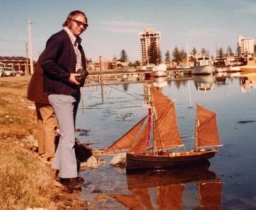

How she looked when Pat first built her,
and on the water,
and Patrick with another of his boats, he was sailing both on that day,
