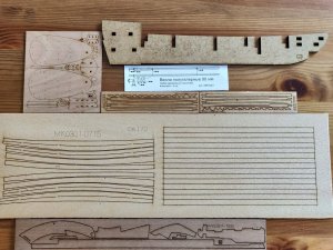

All the wooden parts are laser cut, the Bulkheads have bevel lines etched on and the instructions also mention about which way to fit the Bow and Stern Bulkheads so that you make use of the slight angle you get from laser cutting, something I've not seen in instructions before. The way that the Bow and Stern Bulkheads are fitted mean that these areas are virtually solid and that will make fitting the second layer of planking a bit easier. The second planking strips are very thin and the instructions recommend that you coat the rear side with diluted PVA before removing them to stop them splitting.

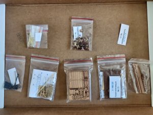

The various Deck fittings, Pumps, Gratings etc are small kits seperately packed with their own instructions, the Anchors and Guns are already blackened, and Photoetch sheets for the metalwork detail. There are 4 spools of rigging thread and some material for the Sails. You can buy pre-made Sails, but I am going to have a go at making my own.
