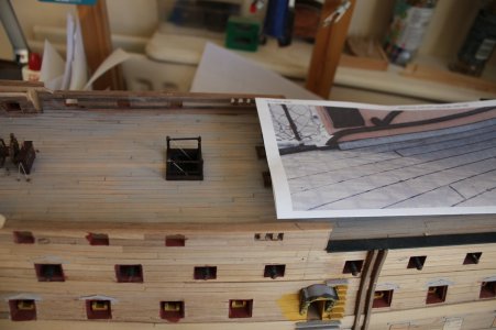

This is the deck of my HMS Victory after one coat of dove grey dye, compared with a photo of the 'real# Vic. The light has fooled the camera, as my photo doesn't show much grey, wheras the print-out photo has caught the sky's reflection. Further coats may bring the grey out better.
I bought Hard Maple from a country sawmill that had been in an outside stack for a long time. The surface was silver grey.
I doubt that at present the decks of Victory are sanded daily. A flagship in 1805 probably would have been. A heavy curling stone rubbing sand would have the deck looking like a freshly sanded piece of Oak or Pine or Elm?
Victory was a different ship about every 10-20 years while in active service. As a store ship or another moored perm. and neglected duty would probably have a Dove Grey colour. It would depend on which slice of time in Victory's life is your model representing.
It could also be tar footprints or black powder or pools of dried blood, urine, and poo.

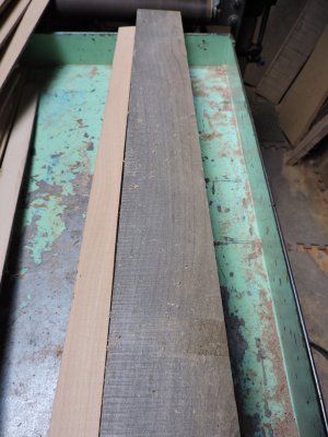

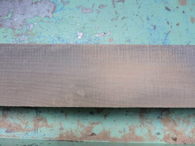

Here is a piece of white oak i cut a strip off the side so you can see the actual color it is a tan color
then i sanded a section and guess what it did not turn white it went back to the light tan color
so stark white decks on models is a style
