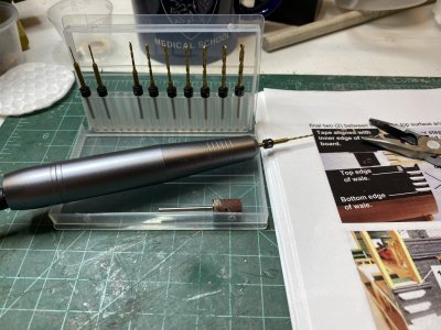

I have a dremel corded and find it very awkward to use. I have been using a nail drill that I picked up from Amazon for $13. It is much lighter weight and easier to control than a Dremel. The shafts are not the same size but arrowmax drills fit it. I use it mostly for sanding and drilling holes. It does not have as much torque as a Dremel but it is more than enough for my needs. I highly recommend it for use on model building.
These tools definitely do not have the torque of a Dremel but they do a decent job especially on the softer woods we commonly use. The great advantage of them, especially for me, is that they are quite compact, fit easily in your hand and are not as bulky as a Dremel. They are much easier to use around delicate parts. The sanding drum comes with a number of different grits and you can buy more cheaply. I use mine constantly while the Dremel is used only occasionally like for cutting metal tubing. You can't beat the price.

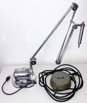

The Buffalo Dental Equipment Company dental engine is what the old-time dentists used to drill your teeth with. The "bench engines" are what are used for bench work in dental labs for making dental prosthetics and the like. There is a huge range of handpieces available for these and many types of bits and burrs that can be held in them. This is really the best tool for doing powered micro-carving and the like. Foot pedal speed controlled. Reversable rotational direction. Excellent "professional surgical quality" construction and materials. The belt-driven armature may look cumbersome to use, but it is quite the opposite. This machine is made for drilling and grinding inside your mouth, so it has no trouble tackling any job you'll encounter on a ship model. The handpieces are ergonomically designed for fine work, unlike the big, heavy and fat Dremel mototools. Dental engines rely on torque to get the job done, not speed, so you can slow them down to where you can easily control the aggressiveness of the cutting action without losing any of the power to get the job done. Dental engines can get very expensive. It's not unusual for a new dental engine and a couple of handpieces to cost more than a $1,000 USD, but the good news is that there a quite a few used ones on eBay and the like because the dental lab technology is changing and new casting and 3D printing technology is replacing a lot of the free-hand shaping that used to be done with these workhorses. I got mine in like-new condition with a handpiece for $75.00 on eBay.
Buffalo EMESCO labeled dental lab bench engine:

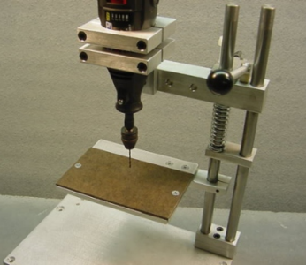

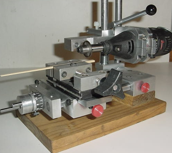

It should be noted that Vanda-Lay Industries makes a quality selection of light duty tools such as drill presses and milling machines powered by either the Dremel mototool or the Foredom flex-shaft machines mounted in them. The Vanda-Lay tools are much better than similar ones offered by Dremel and Foredom. These light duty drill presses and mills are not as good as dedicated power tools, but for a modeler on a budget, they are an excellent compromise. See: https://vanda-layindustries.com/
Below: A variety of Vanda-Lay tools for drilling, milling, sawing, and turning. Dremels shown mounted in the tools. Foredom handpieces are mounted in the same way. Specify Dremel or Foredom sized clamps when ordering.

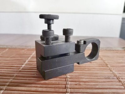

Dremel rotary tool: high vibrations, hence deafening noise, particularly at highest speeds, plastic, non-rigid construction sensitive to sideways loads, large run-out, awkward shape of the tool making it somewhat troublesome for making holder attachments, the lowest available speed much too high for typical small-scale jobs (this comment applies to older model in black color).
Proxxon rotary tool: much better precision (run-out) and generally much nicer “culture” of work, quiet without much vibration even at highest speeds, better speed ranges, i.e. lower speeds available than Dremel provides, rigid strategic components made of metal less sensitive to sideways loads, all rotary tools from the Proxxon range feature a very convenient 20 mm diameter neck in the best place, i.e. at the very tip of the tool (making it easy to self-make holders that "automatically" maintain perpendicularity and parallelism, such as the one below).
